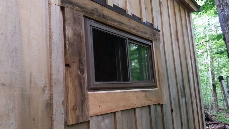

I have a shed similar that we turned into a shabin quick and dirty. No insulation and 2 small windows. I built 2x6 jam extensions and uses 2x6 for the face trim. The key to making this half water resistant is that piece of Z flashing at the top of the window and caulking it. Notice its behind the battins too. If your going to insulate I would cawlk every batten inside and out. Mine had a few gaps after about a year. With no insulation you can really see any air gaps.

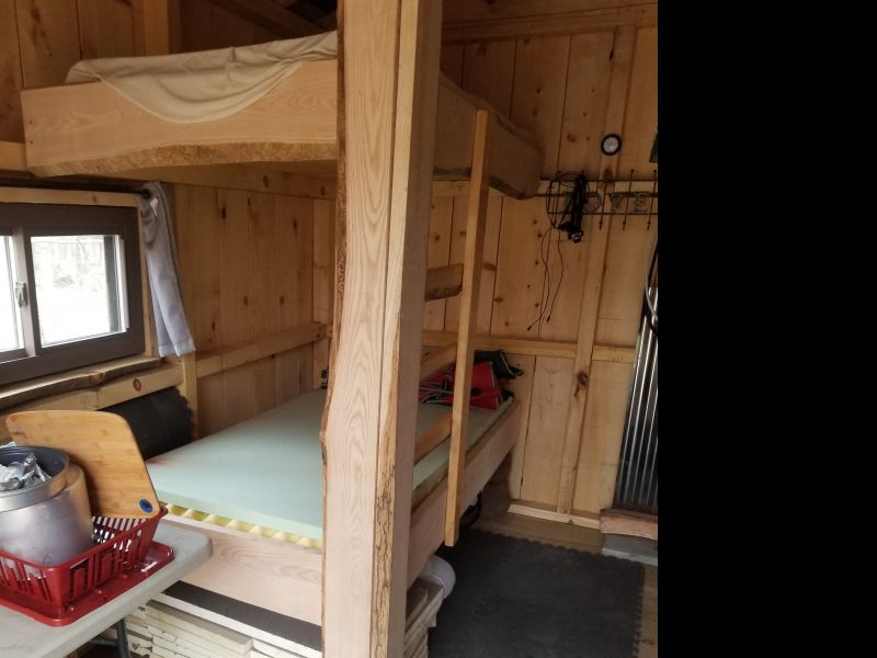

We used this 10x14 shed as a cabin for 3yrs and while we built the real cabin. It was cold in the winter and hot in the summer. I'm really thankful for our real cabin as it has let us use the property year round now.
