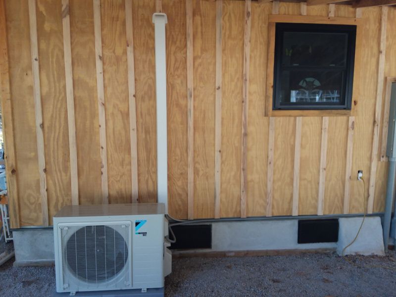

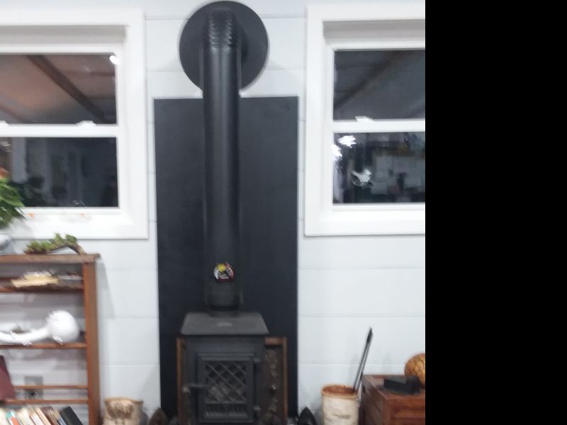

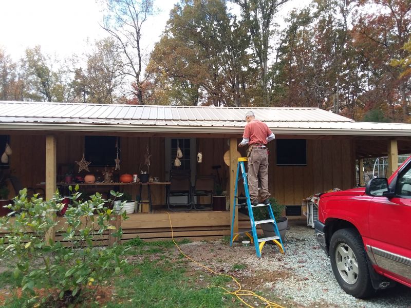

I added 1/2 inch insulation board and T1-11 with battens. I used Cabots clear stain but it came out kind of yellow. The battens are green from the lumber mill. I'll stain them later. I installed gutters and mini split. The little Jotul wood stove will run you out of the cabin with the extra insulation added.
