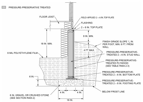

The pic is from chapter 4 of the above link. a treated wood foundation on a gravel trench. No concrete, braced and with continuous floor support, recognized design.

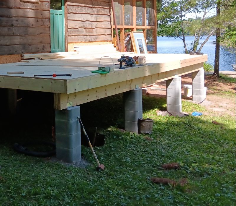

In our area the local Rona building center carries 'bull nose pier blocks' that are 12x12. I used them when building piers for an addition this spring. I dig down, pour an 18x18 pad on the bedrock, drill rebar into bedrock, and thread blocks over the rebar as I build the stack. The stack is filled with concrete as I go, and final block trimmed or padded at desired elevation. 6x6 saddles are set into the top, and hold the beam in place.

Looks substantial, I like it
