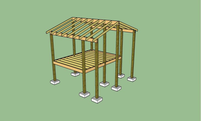

Doodling...
The posts are 6x6 treated on footings. The walls brace the posts as they continue beneath the floor, there is not a connection there as with a pier and beam, this is rigid.
The floor perimeter is double 2x10's, the connectors are Simpson HUC210-2's. The joists are 2x8.
Without knowing snow load the roof is a WAG, 2x6 rafters, double 2x10 elsewhere.
Wall and wrap that box, drop the deck ledger a couple of inches below floor height inside to keep rain and leaves out, flash behind and then over the deck ledger (flash and counterflash) and that will not be an issue.
9 proper holes vs 25 gopher holes and a whole lot stronger.
I'm not a fan of a tiny porch, that is where it is at .
