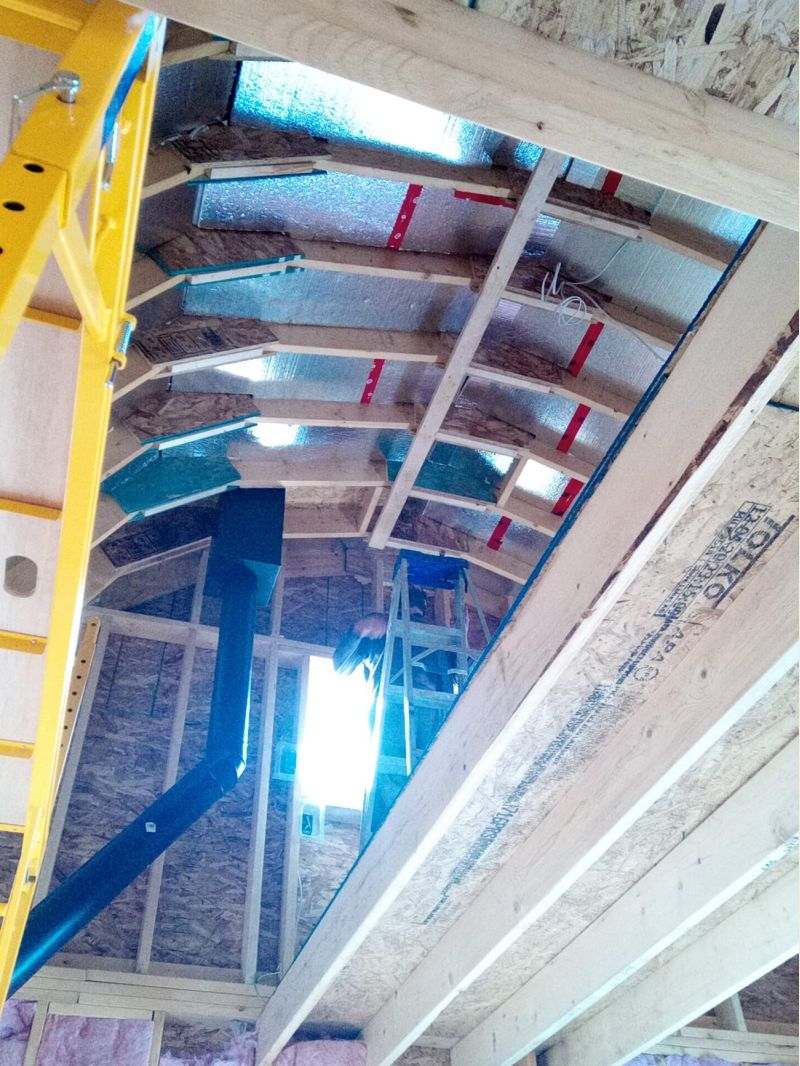

Here is what I did on our roof.
We used foamboard and made a 1" channel from the soffit to a ridge vent. We did this by using foam spacers that we glued to the bottom of the roof sheeting (on the inside). Those spacers ensured that the foam board couldn't be pushed tight to the sheeting when inserted between the roof rafters.
Once that was complete, we filled the rest of the bay with fiberglass batt, and finally drywall. This gave us an R-value of about 25 as we used 2x8 rafters. Our walls are 2X6 and insulated with fiberglass to an R value of about 21.

You want an air gap below the sheeting that allows air to move freely. This keeps the sheeting from overheating and dry rotting. Its especially important if you have a metal roof.
I included a picture of our cabin. This picture is right after we finished putting up the foam, but before the fiberglass. Between the foam and the roof sheeting (plywood) is the air gap. That air gap goes from the soffit to a ridge vent. This allows air to move from the soffit all the way up and out the ridge vent.

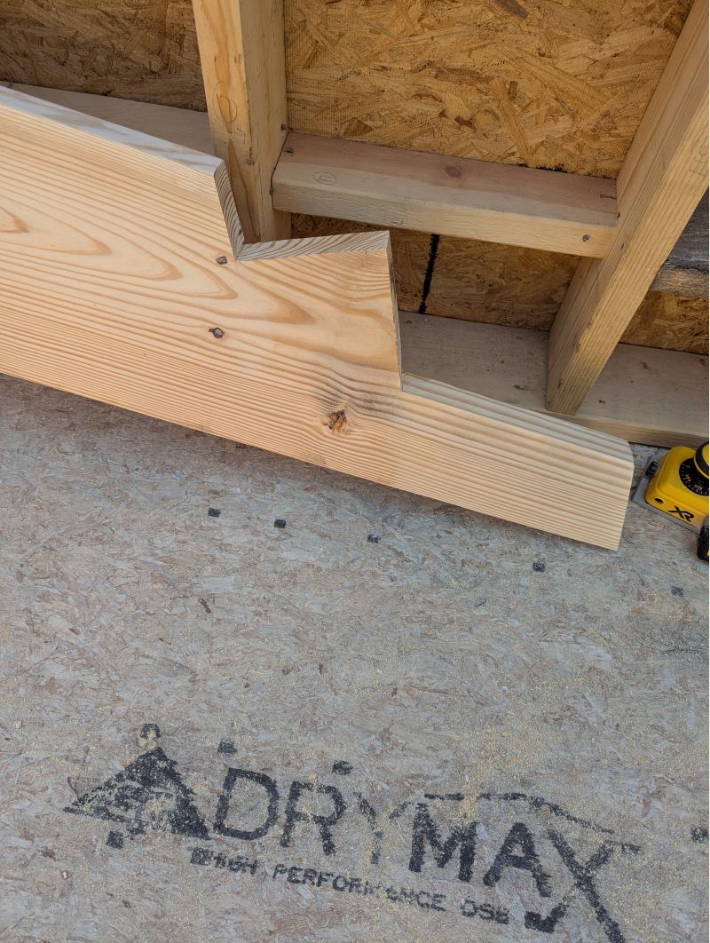

NorthShoreSLR

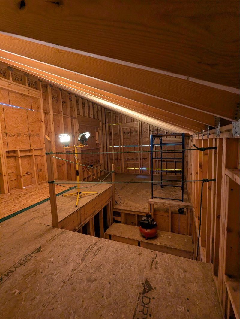

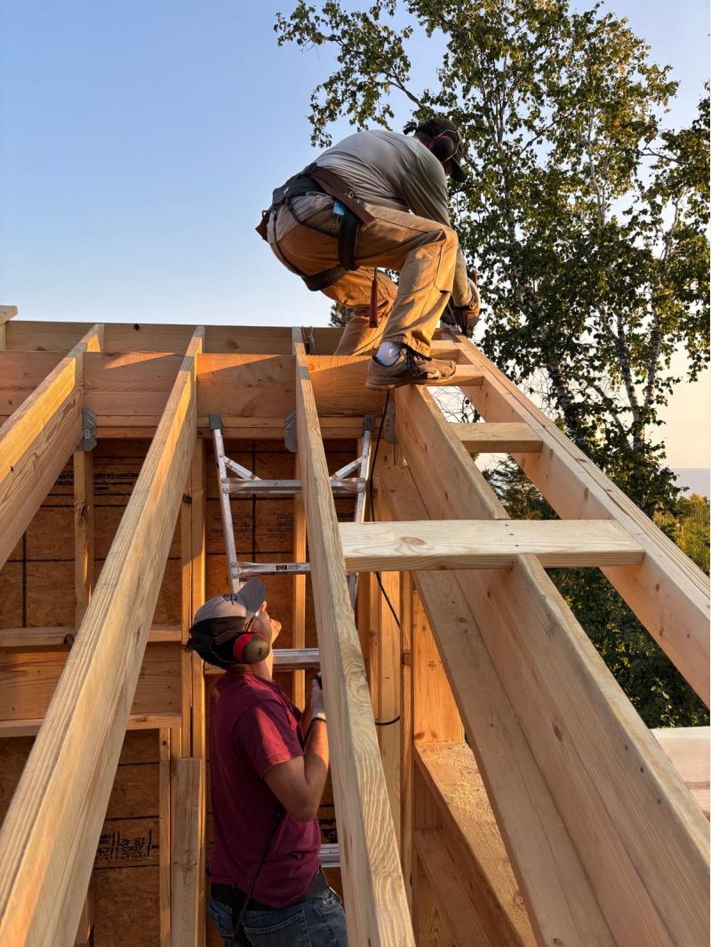

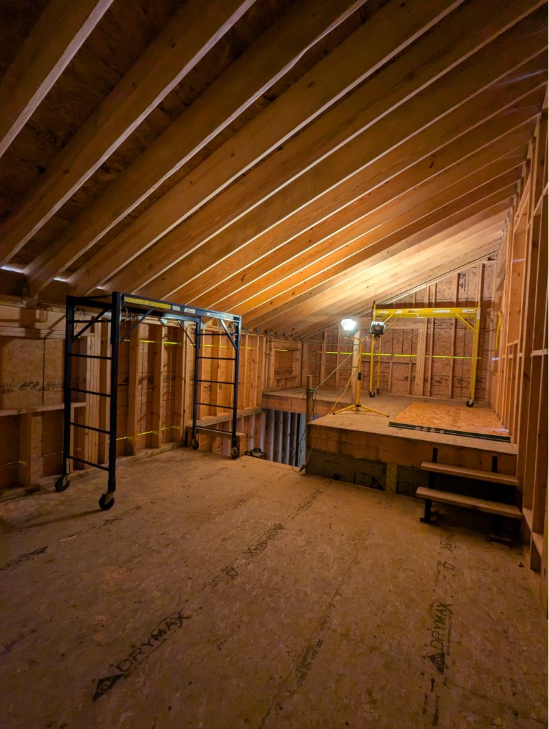

# Posted: 16 Nov 2025 02:00pm
Pix for reference.
Rafter tails (upside down)
Roof Framing
Roof Framing
DRP
# Posted: 16 Nov 2025 08:22pm - Edited by: DRP
There it is,
I feel like maybe we jumped the gun with installing the metal roof and maybe the roof decking should have been insulated from the exterior first, in order to stop that thermal bridging of the rafters?
Part is the bridging, part is not being able to get a good seal if you cut sheet foam and can foam it in place, moisture is likely going to get to the roof deck and condense above the foam where it cannot easily dry in either direction.
I've hoped you would find a solution based on where you are and what you have to work with. Here's another article more to the point;
https://buildingscience.com/documents/reports/rr-0108-unvented-roof-systems/view
Some of it has to do with how much indoor moisture there is. You said dry cabin. I assume seldom used in winter and the ability to hold some moisture and dry between visits. There's the reality check in this, what is the moisture load.
One way/ best way, carefully remove the metal, put down the foam sheets, stagger, offset and tape the seams, ply over and reinstall the metal. You can install 2x4 vertical strapping over the foam in that scenario, then ply and metal. That would provide a venting channel without causing metal condensation issues.
Another is to bore vents into the blocking of each bay, bottom and top of slope to create a vented assembly.
For future reference when framing that roof, make the upper notch as small as possible... or bevel the upper plate. The inside corner of that notch is where the crack begins, keep as much meat as possible there.

It looks like you put blocking in that wont allow air flow. Not much point in venting and leaving a gap if you cant flow air.

Brettny, it would be pretty easy to drill some holes in those blocks at the top to allow for venting, right? According to the building science links shared above, more venting at the bottom is what is crucial, and less at the top was okay. I wonder if this is more true, as the top side is the south facing (full sun) side?
# Posted: 19 Nov 2025 06:19am
Theres a spec for the opening size needed for length of roof. You may need to totaly remove them. I dont think a few holes will work.
