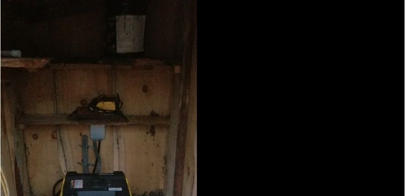

I have a shed that the siding is also the wall studs. The siding is 2in thick sawmill slabs. It just houses a generator. But has been drug around the property to many locations.
