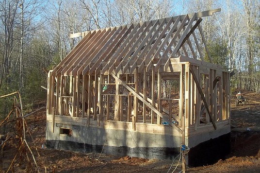

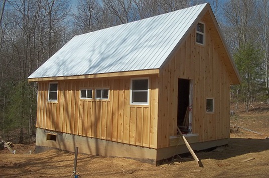

16 wide with a loft will not go down the road. Unless it is on steel girders you'll likely break it before you move it. I'd view this as the core, build it with a real foundation and provision to add on later. Below is 16x28 with loft above, its about 20' above the foundation and just enough room to stand upright under the ridge above. 13' above the road is max road height and there are axles and frame in that. At 16 wide it is pretty much all 2x12's. I seriously doubt you would or could move it.
