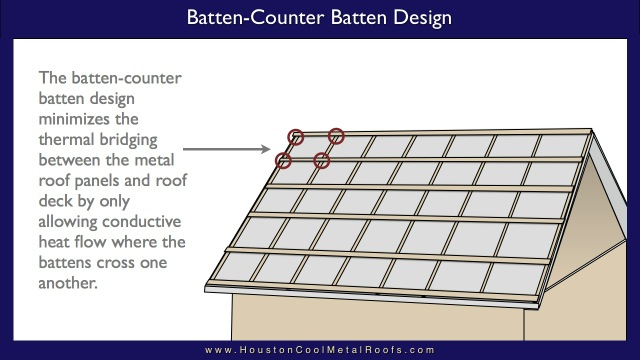

# Posted: 2 Feb 2026 11:59am

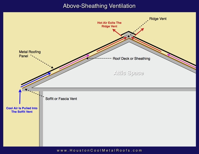

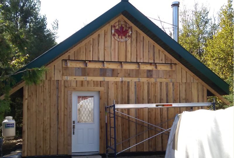

Your contractor "guy" is correct. Do the walls, then wrap, then add the exterior 1" Foam Sheet, then strapping running VERTICALLY anchored into the studs/frame then Horizontally to attach your back boards to allowing for at least 1" space between boards then your battens to cover that gap. This provides an "air gap" thermal break which will not hold moisture and prevent heat/cold transfer from the outside to the inside.
If you do your Roof in a Cool-Roof method, you can connect that "air-gap" to your soffits so that as the roof warms, convection will pull the air up and vent it out on the Roofs Ridge Vent, which further prevents humidity or damp + keeps the structure neutral.
I designed my home using these methods and it's seriously efficient and having thermally broken walls/roof really prevents heat gain in summer & heat loss in winter... IE: My Radiant heating only runs 3 cycles of 2 hours within a 24hr period to maintain 25C/75F when it is -30C/-22F outside. In the summer when it is 40C/104F outside, the house never gets over 27C/80F and I no longer own an AC system.
A difference to your Board-Batten, I did Live Edge Cedar, using 8" cut cedar backboards with Live Edge Cedar face boards on the exterior. My roof is Forest Green Tin, so it does pretty good convection and run a full length Ridge Vent which pulls lot's of air up and out.
*NB: I am within a protected northern arboreal forest, which is primarily evergreens, and therefore my home blends in and is almost invisible as a result. The downside is that chipmunks & squirrels think it's a huge tree and run up along the sides sometimes.
** The roof seems thick, well it is, from the inside finish to the outside of the tin it is 13-1/2" thick, with PolyISO Sheet Insulation between the rafters.
Some photo's attached to help.

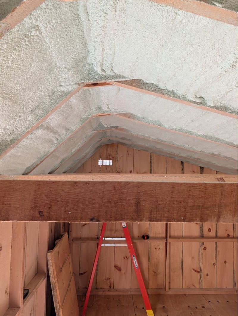

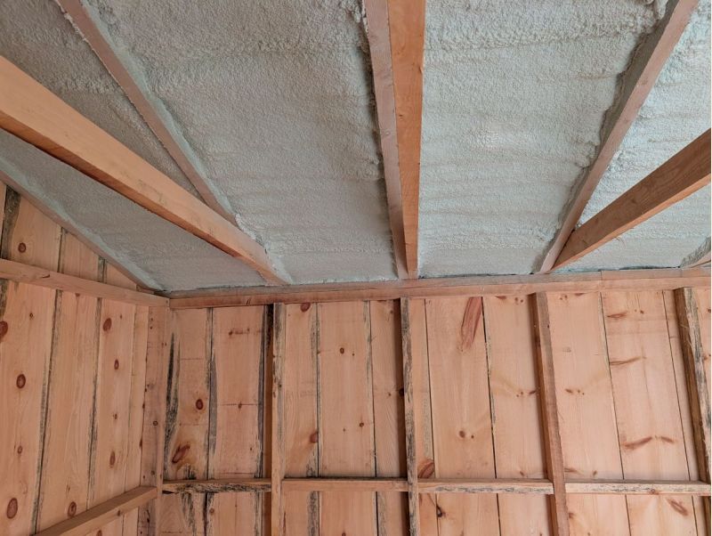

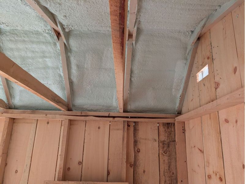

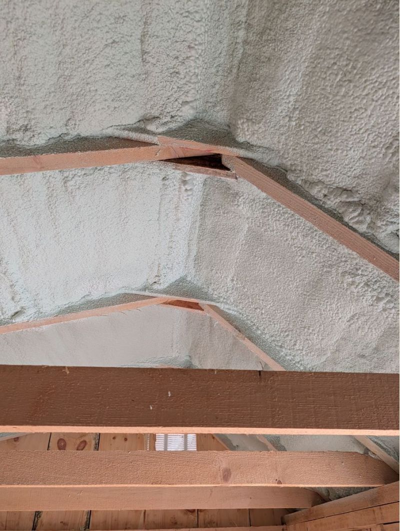

# Posted: 30 Mar 2026 04:25pm - Edited by: utherjorge
OK! The ceiling has been spray foamed. Pics for attention below.
I asked the guy (who is a spray foam guy, not a batten guy) whether I should use a plastic sheet/vapor barrier if I use Rockwoll. He didn't think it was needed. In short, since I'll have HVAC and it's a small space, he didn't think I needed it...but he also wasn't sure. Thoughts?
