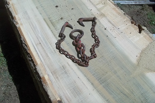

Attached is a pic of a set of chain dogs, aka hammer dogs. They are not as fussy about size range but then you need a hammer to drive them. If you find one with a larger ring, chain and single hook it is a ring dog, cut a pole for the ring and it is a cant hook for the woods.

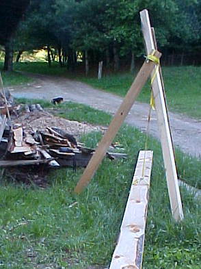

The 2nd pic is "walking the dog". A lashed A frame with tongs, chain, rope... dangling from it. The log is suspended under the legs which are set ahead. Push on the A frame and it lifts the log and slides it forward, rinse and repeat. I've walked logs and timbers out of places I couldn't get anything else to.

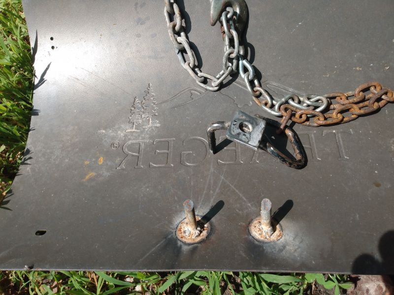

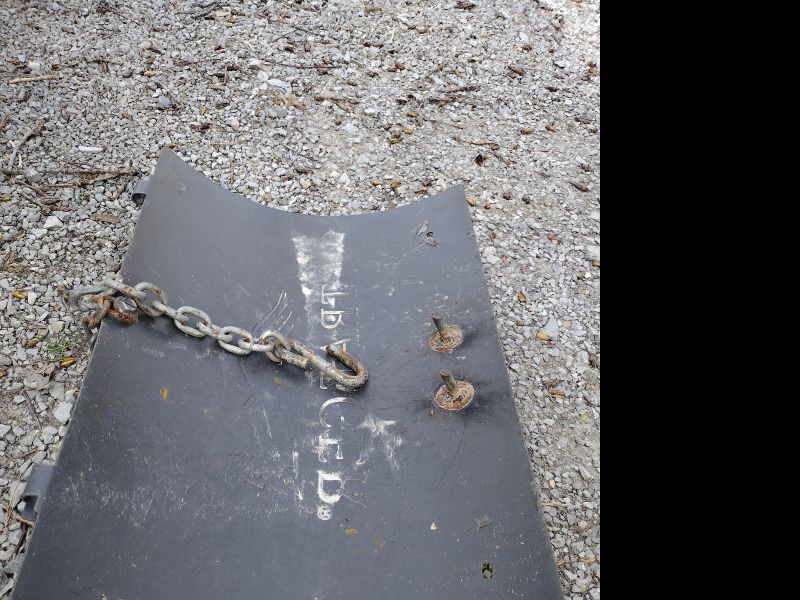

I made a skidder pan out of a traeger grill lid.
Just roll the log on the spikes, then I made a set of hammer cleats like DRPs chain dogs. I hook it up, hammer the cleats in and go.

# Posted: 25 Mar 2026 02:26pm
Way cool!
That brings to mind, google skidding cone, maybe Bailey's has them can't remember. an old 50's car hood was another old school way.

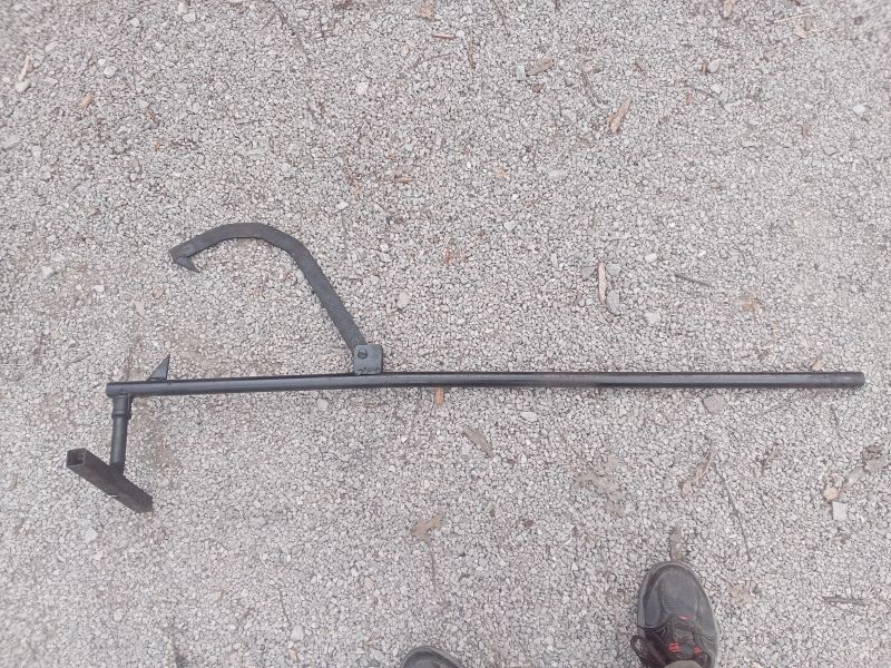

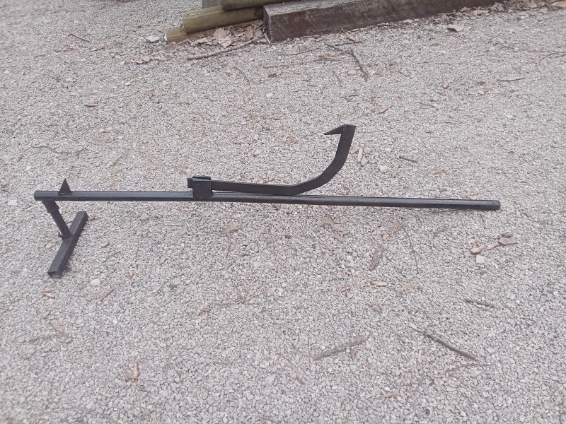

Here's something else I made.
It's a combo timberjack/can't hook.
You can lift the log off the ground to buck it to size or if needed remove the foot and just use it like a can't hook.
It just black iron pipe and steel.
# Posted: 25 Mar 2026 06:42pm - Edited by: gcrank1
Yep, Ive got an old homemade one too, dont use it much but when I need one it is there
