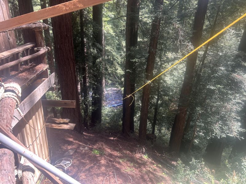

I’ve decided on the final route for cabin to shop rope through the trees and down the hill, see mock up. My plan was/is to attack a milk crate and pulley stuff up and down. But I got to thinking about ski chair lifts, why not just haul my ass up and down too?
It’s about 250’. I have a 12volt cable winch but probably has 50’ at most. How far do ski lifts go between poles?

Thanks guys. I’ve been dreaming of two schools of thought. First one, I have trees 1-2 foot diameter trunks I could winch a cable 10’ off the ground probably tight enough to hang a seat from. Second and more appealing is the cart and tracking in DRPs video. Coming up with 200” of tracking is another matter..

If you're hanging weight from a generally horizontal cable there's going to be some serious tension or some serious sag. Just look at a ski lift counterweight.
OTOH if you're just using a cable to pull something along the ground, the tension is only what you need to pull it along the incline.
I remember seeing a ski rope tow in the 1960s; it was just a tractor on blocks with one tire removed; the rope wound around the wheel as a pulley on the uphill end.
