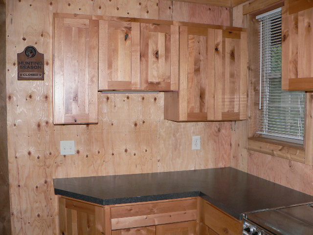

I built my own counter and also covered it with formica. I did lots of research before diving in. Its an absolute snap to do. Here is my work. I havent added the backsplash yet.
First Formica Counter Job

Thanks for the great pix Toyota!! Let me ask.. are you concerned with the freeze of the winter. What you have is exactly what I am going to do. Love the cabinets....did you build those? My only concern is freeze and thaw but Vince P says mastic is the way to go. I am thinking of nice slate tiles as a backsplash. I'll post pixs once complete. Thanks!!

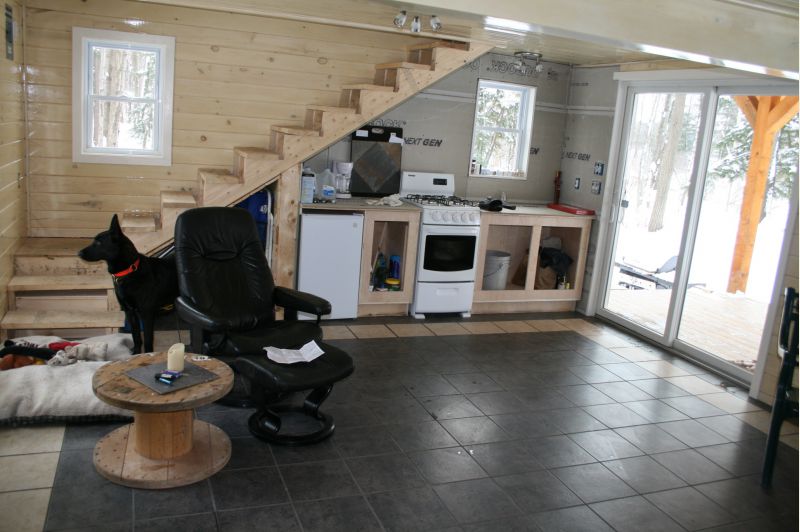

I'm located in western MA where it tends to also get very cold. I used cement board on both the floor and kitchen walls for tile. Used mastic on kitchen wall and countertop, used thinset on floor. Managed to get through first winter with no cracks. I did put cabin on 5' footing tubes to ensure adequate frost protection.
cement board in kitchen
view of tile from loft
tile in kitchen
tile in kitchen
# Posted: 4 Aug 2011 09:24am - Edited by: toyota_mdt_tech
Quoting: GointoClarksvi lle
No worries about freeze or thaw. Area is dry, not a lot of humidity. I think that will help. I had the cabinets all custom built. I have a friend who hooked me up with $6500 worth for $2100 (he is in the business). All the drawers have that "blu motion" or whatever its called, it closes itself slowly at the end, same for the cabinets, you will never hear cupboards or drawers banging. The cabinets are made to look like it was built out of 100 yr old barn wood, ie worm holes, dings and dents, knots (these were actually put in by the builder)
In addition to adding backsplash, I will do something else on the walls behind the counter, not sure what yet. Maybe small tile...
Picture of eating counter, I will be removing the trim under the windows and elevating the eating counter to right under the widows. Right now, its too low by about 4 inches. You want 12" from eating counter surface to seating surface.
