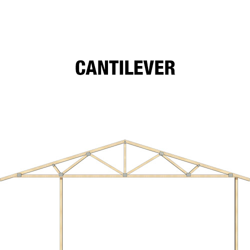

In the process of building a cabin.
The front porch will extend the length of the cabin (40').
I went with a cantilever truss design to do this like the attached pictures. (hopefully they're attached, first timer here)
I'm curious if I need to build a divider wall in the attic between the porch roof and cabin roof when I insulate?

My personal opinion & experience says to put a blocker wall and insulate it leaving the overhang uninsulated.
You do not mention the method of insulation, venting of roof (cool or hot roof).

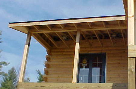

I'm also trying to figure out how to do my bird box returns. I plan on building a fake beam across the front of the porch and putting post from the porch floor to the beam. I'm thinking I need to run the beam all the way out to the overhang on the eaves and then start my return or Bird Box from there? Hard to make it make sense in writing. I'll try to post some more pics later.

Soffit and gable tends to short circuit and vent near the ends and that is all. I was taught to pick one, gable to gable or soffit and ridge. In some areas gable vents can bring in snow in the winter.
If I'm understanding, I like to put the "return" in line with the wall when possible. In the pic I've run the gable end at the rake angle all the way to the subfascia, there may be a narrow level strip covering it. I've levelled the eaves soffit and did put soffit vent there. The leveling stops at the wall rather than happening out at the barge rafter, which looks clunky to my eye. In this pic, the "return" is an extension of siding.
