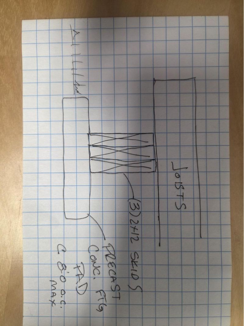

# Posted: 24 Sep 2026 12:27pm - Edited by: montecristo
Quoting: Brettny
I wouldnt try to over engineer this since its basicly swamp land. Your going to have to jack and re level every year or two. Your not going to be able to just turn the screw and level the place. Personally I would use the cheapest widest foot print I could buy or build. I wouldnt be afraid of useing wood blocks on say 2x2ft concrete pads.
You're right. I am just making this over-complicated. With what I had said before, I would potentially have (15) jack to try and screw to level. It would never be easy.
Maybe I should just go back to what I was originally thinking with skids over pad footings like shown in the attached. It won't be any more or less difficult to re-level every few years.

# Posted: 24 Sep 2026 01:43pm

A strong skid made from tripple 2x12 would be a bit easier to level than a thinner skid.

My cabin is 16X28 with a 2/3 loft. We used concrete pads on gravel, then cinder blocks on those (oriented properly), then ground rated pressure treated 2X8 pieces on top of that, then the cabin beams on those.
We originally thought things would move, but its year 4 and almost no movement (couple of small drywall cracks at seams). However, our plan was to use bottle jacks to relevel, then wood or floor tiles as shims. So far it has not been needed, but that is still the plan if things move.
spencerin
# Posted: 24 Sep 2026 09:09pm
Do skids over pad footings. Well constructed skids over many footings on top of good bases will reduce the speed of settling and frequency of re-leveling.
