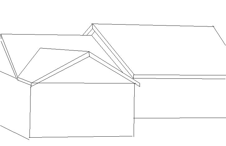

You might be able to have the addition lower and wider by making the junction a hip roof. You'd probably need to cut back the last rafter or two on the existing roof at the peak, and extend them at an angle at the eave, but that should allow you to switch the direction of the slope and still have a single roof line.
Not a perfect illustration, but this should give you an idea
