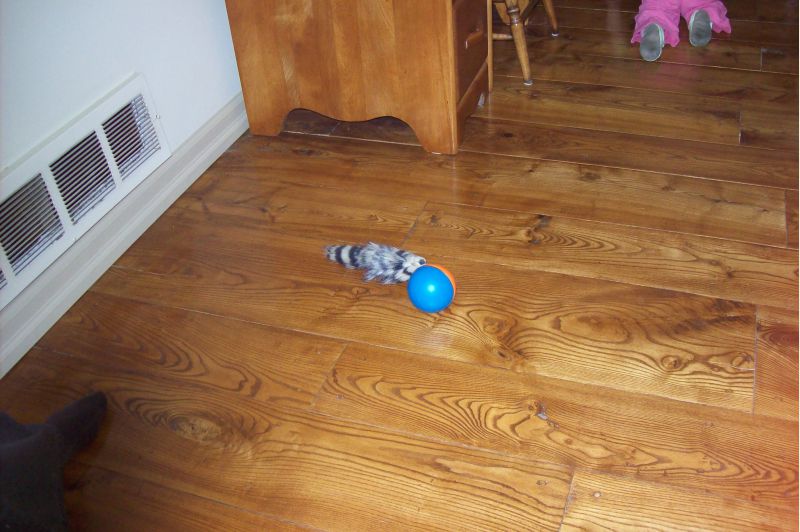

make sure the flooring is very dry. should bring it in the cabin for a month before if you can , put the floor down and then wait 2 weeks before you sand ,much better if you can do it during the heating season when everything is dry.. this one is 400 sq. ft. white ash , 8's 10's ,and 12's lots of work did it with a random and a hand belt sander,,
white ash
white ash

Thanks Just, your floor looks AWESOME! How many coats of poly did you put down and how long did it take to dry? We've budgeted a full overnight between coats and a full week to cure before we walk on it or move in any furniture.

one coat of early american stain two coats of oil based poly , sanding after th first coat of poly,,,went back and did a few bad spots the third time 24 hr. between coats and nothing on it for a week,, been down about 15 years , havent done anything to it , still looks new , have a few seems i wish were tighter but we like it very much . it is in our home not the cottage . it get's very little use. never seen a shoe!! it is all drilled and pegged not t&g cut from our own bush ..good luck sounds like u have a handle on it..
