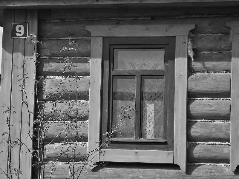

Well, the windows are in the bucks and really look good and tight. I noticed that the vertical bucks extend from an inch to a 1/2" depending on the size of each log butted against the buck....inside and out. So, what I want to know, what is a way to install the window frames themselves so they're all straight and look good? I took a photo on another log house window nearby...this is the look I'm after. Thanks so much, yet again.

# Posted: 29 Sep 2011 04:56pm - Edited by: toyota_mdt_tech
I'd frame in each window opening with that 4X6 header material on its side (wide end pointing into the window opening), bottom and top run, then fit the side in between, so it can actually act as a header for the log about it too (you wil get soem shrinkage whent he logs dry) , make it square. Make the opening the size of the window being installed, maybe an inch bigger on top and bottom, shim as needed. I'd cut down the larger logs that lift up the trim (bucks as you called it) so it is able to set flat on the header/window frame, then logs much bigger, cut back so the buck can fit flat and I'd chamfer them at a 45' angle if they are taller than the buck. This is just one of many ways you can do it. I'd. Finish inside with maybe some 1/4 round to hide the shim gap after a nice sill in installed.
