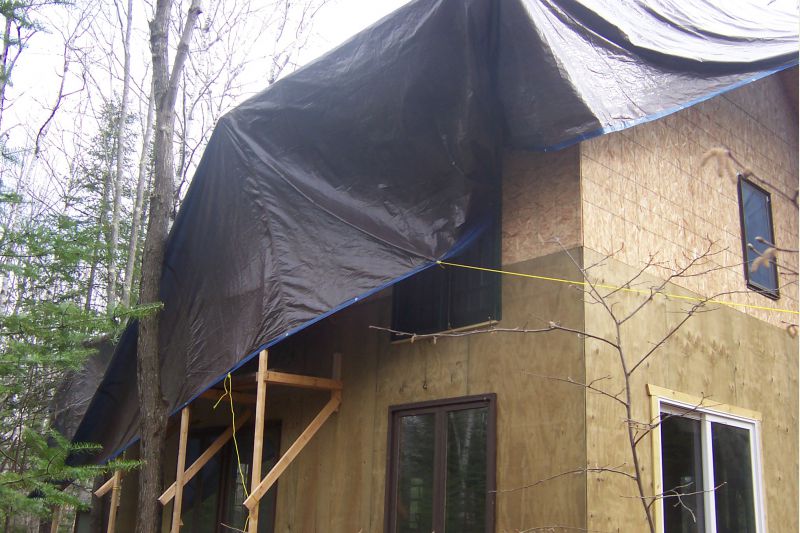

A good secure waterproof tarp should do OK if you are there to maintain it regularly and if you set it up so that it drains well and doesn't pool water. Maybe even double-tarp.
I had just a cheapo tarp over my shed roof (sheathing and felt materials only) for two entire years, up to 30" of snow avg on the ground up here), and I finally got around to installing the roof a couple of weeks ago. Removed the tarp and the roof was still perfect; nothing even wet underneath.

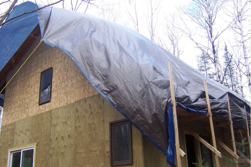

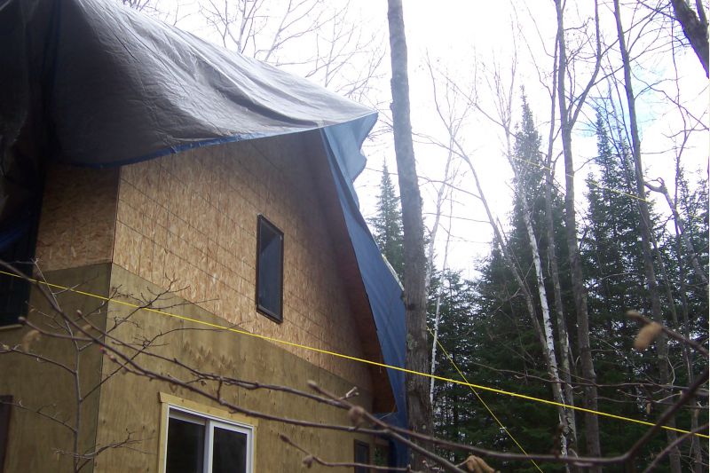

jrbarnard, don't let this scare you- we have been building for over 2 years. We haul up what we will be needing and extra stuff we store either inside or under the cabin. We sealed our sub floor with water proofing and that helped-no swelling. It does remind me of one of our not so good moments though - early spring last year we got up to the cabin and the majority of our tar paper had blown off the roof. Then it poured rain and we had a mess inside and some panic set in as we did not want the insulation in the floor getting soaked. We scattered every bucket we could find around to collect as much rain as possible while we ran to town to buy the biggest tarp we could find. I won't go into detail but let's just say it would have made a great comedy skit watching just me and my husband try to get a 40x80 tarp up and over about 26 feet of vertical height. Amazingly we did manage though and did not kill each other! We lay in bed that night hearing it blowing in the high winds and I half expected to find the cabin air born by morning:) Needless to say, the very next weekend the shingling was completed!
You can do it too!
I might add that neither of us stepped foot on that wet ,slippery 12x12 pitch roof to get that tarp on!! It is currently rolled up in a ball still needing to be dealt with(it is ripped to shreds)and I cringe every time I see it-Grrrrrr.
