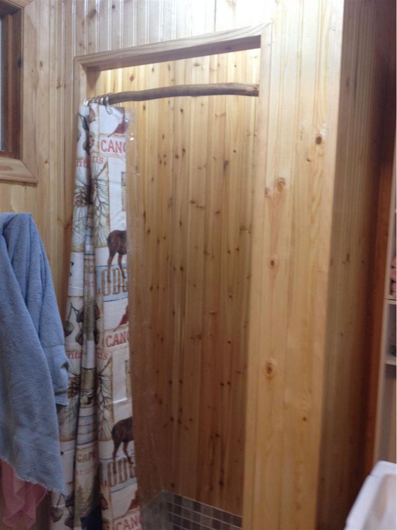

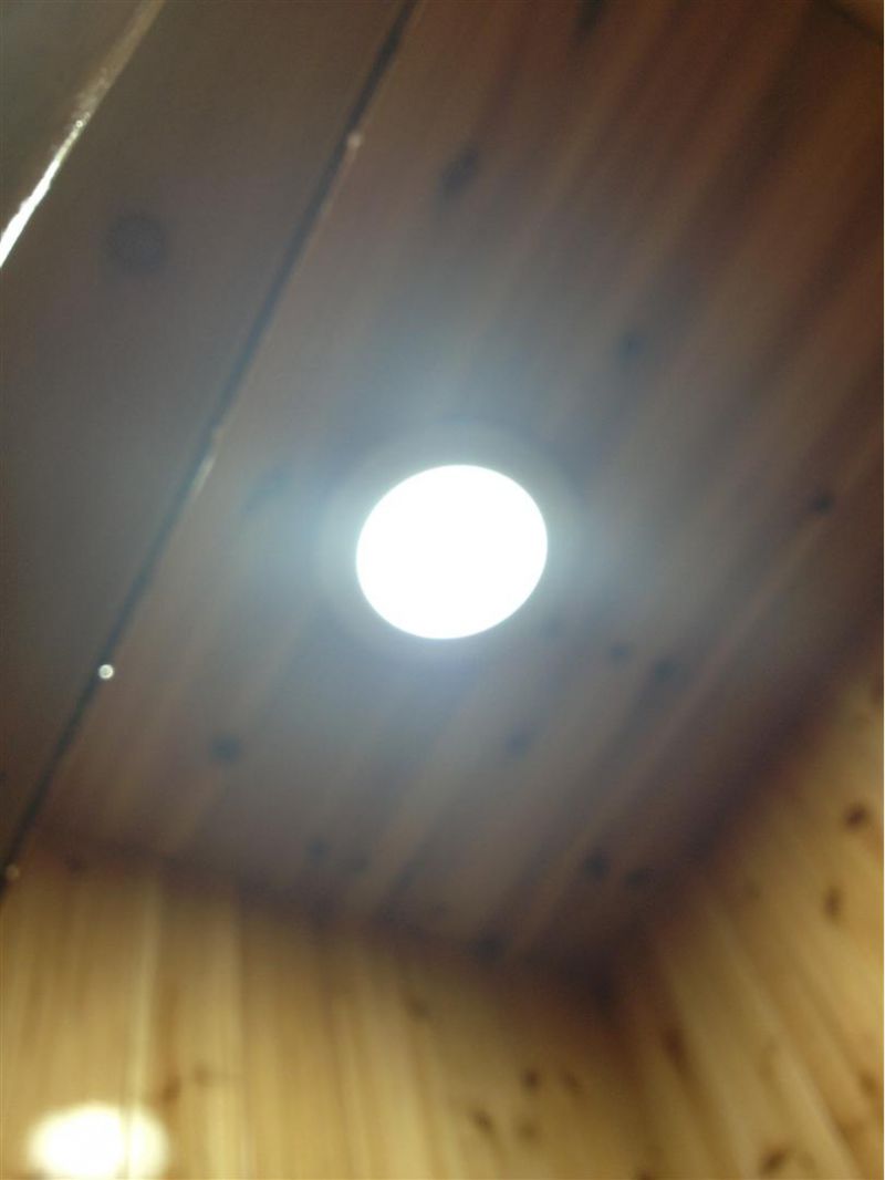

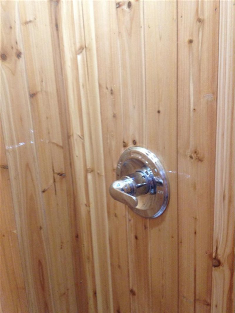

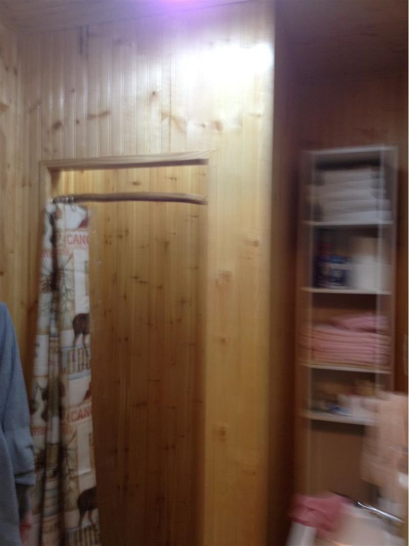

# Posted: 18 Jan 2012 03:30pm
The bathroom is about 95% complete in these picture only a few pieces of trim here and there. IMG_0065_Large.jpg

# Posted: 7 Jun 2013 04:30pm
Well it's been about 1.5 years using this shower about 3 times a week average, so far the wood is holding up great looks just like the day I installed it.
We do have a squeegee we use after each shower and then wipe the wall down most of the time.
So if you are in a bind and have an odd size to work with this is an option.
