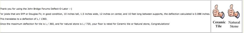

# Posted: 22 Oct 2011 07:32pm
Yeah, with ceramic tiles the biggest problem would be too much bounce in the floor causing them to crack.
# Posted: 22 Oct 2011 07:57pm
Just keep the deflection to L/360 or less
check this calculator
# Posted: 22 Oct 2011 10:35pm
Very handy calculator!!! It is so easy to use-wish all span type charts were as nice! Thanks for posting it.
brownsburg
# Posted: 23 Oct 2011 06:05pm - Edited by: brownsburg
Yes, thank you for the deflection calculator.
# Posted: 23 Oct 2011 06:52pm
Yeah, ain't technology wonderful!
