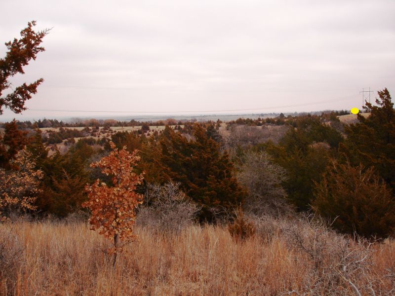

Attached is a photo with a yellow dot that shows (barely) where we're building. It'll be facing away from the power lines. We're at the crest of the butte and the view is quite nice.

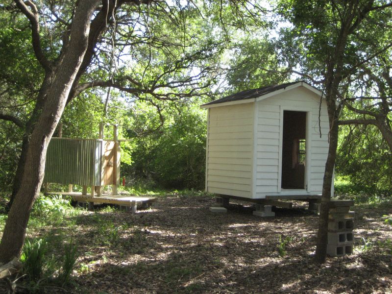

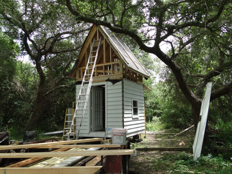

mrmiji, we started with the 8 by 8 shed, pulled the roof off and added the loft. There is a 2 foot pony wall added to the top plate of the first floor and a very steep roof on top of the pony wall, that was so we had room to stand up in the loft, very comfortable that way. Cots fit against outside walls with access ladder in the middle. Head room is important up stairs. Ventilation duct is a great idea, we need to add that to our place. Sounds like a very solid plan, can't wait to see it.
