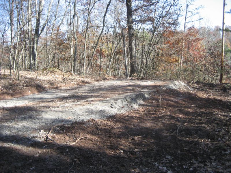

Cabingirl
# Posted: 13 Dec 2011 02:40pm - Edited by: Cabingirl
  I put my foundation on the best possible area that would not need trees removed.  I also wanted it by the electric pole (see right of picture), so I can run electric.  Now someone said that I would not get a permit since the line would run over my cabin.  I am not sure if they knew what they are talking about, because I got the permit. I thought they wouldn't give me a permit if it was a problem. Any thoughts?
Rifraf
# Posted: 13 Dec 2011 02:52pm - Edited by: Rifraf
  Thanks,
  I scrapped the land bare with a tractor bucket, and had the local quary drop 20 tons of 2 inch rock , and 15 tons of surface grade gravel on the area, as well as pour a road to the cabin using the same type or rock.
  In this shot the cabin is on blocks, but since then I have taken a backhoe in there and dug trenched and placed peers in there.
  Have my power on the pole now, and a utility plug for my tools, next step is framing.. im still confused on one thing though
  Since this cabin shell has t1-11 siding and no house wrap, some folks have told me not to wrap the inside over the insulation with 6mil ply, because it will cause moisture buildup right beneath my finished walls,  and not allow the walls to breathe,    while others have said the 6mil ply is a needed barrier, what do you all think ?????
AYP1909
# Posted: 13 Dec 2011 03:54pm
 Quoting: Cabingirl I also wanted it by the electric pole (see right of picture), so I can run electric. Now someone said that I would not get a permit since the line would run over my cabin. I am not sure if they knew what they are talking about, because I got the permit. I thought they wouldn't give me a permit if it was a problem. Any thoughts?  There is a potential health risk from the electromagnetic field associated with the presence of the power line.  Since you are only in proximity to a distribution line and not a transmission line the effect may be reduced and, thus, you were able to obtain the permit.
