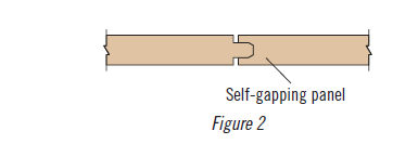

# Posted: 28 Oct 2011 03:44pm - Edited by: MtnDon
In floor sheathing panels the T&G joint is machined so the panel edges do NOT get butt tight by design. The end of the panels can be properly gapped with a 10D nail (approx 1/8"). Not gapping can lead to issues with edges becoming raised if/when the panels expand.
Good Info Link on OSB from Weyerhaeuser
FYI, building that are greater than 80 feet in width or length with T&G panel sub floors require additional expansion joints of 3/4" every 80 feet.
Info on Plywood from CanPly
They also have an illustration of their joint profile for gapping.
self gapping OSB T&G panel joints

Around here, regular T&G plywood is manufactured by offsetting the plys as they are laid up, so the finished face is true 4x8. Apparently the Advantec and similar "high performance" sheathing has the T&G machined in after, so the face is a bit less than 4'.
