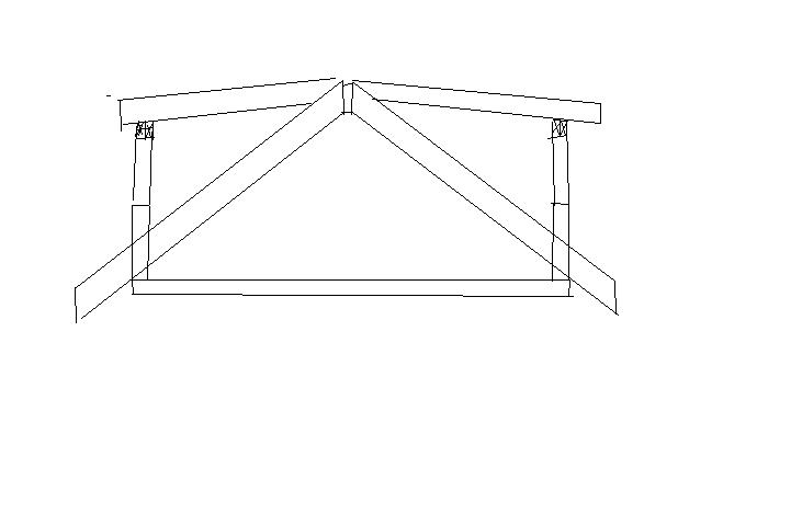

First let me outline the present Loft dimensions. In a 20X30 cabin one end has a loft Approximately 15 feet X 20.
The roof is exactly 8ft giving us 7.5 ft of head room at the center peak and is angled down to the floor on each side. It is a tight dark space.
I am considering raising the roof over this loft on each side but keeping the main ridge joist as is while beefing it up a bit.
Perhaps someone would find this project interesting to noodle around with. More details and drawings can be forthcoming.
Dwight/Minnesota project

Dwight
# Posted: 1 Nov 2011 08:00pm
Thanks for the confirmation!
The interesting part of this project will be re-using the 6 inch pine log joists.
The angle at the ridge will need to be re-cut and I am thinking of cutting/jacking the existing roof up recutting the ridge angle and where my concerns rest is in the strength of the single 2x8 ridge.
A friend suggested laminating in a strip of flashing material to help.
With that approch I've considered having 2x8's planed on a shooter board to plane the "right" angle on to two 2x8 so the ends of the 6 inch rafters do not need to be re-cut.
This concept may or may not be clearly explained and understood.
It may be difficult to describe such an opperation with out pictures
but perhaps you can envision my approch to this project.
