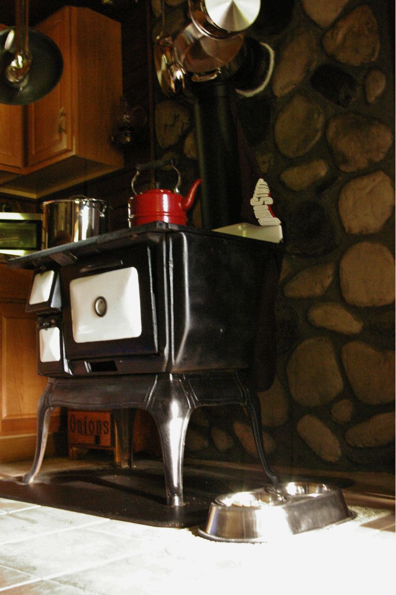

  I used SuperVent double wall stainless from Menards. It's actually made in Canada and is rated at 2100 degrees. The most I paid for a 36" section was $65. My kitchen wood stove needed a 6" pipe so that's what I went with. I purchased the wall spool, cleanout T, brackets, and the roof kit. I used Through the Roof clear sealant around the seams on the roof. Very pleased, did it myself and for under $500.  kitchen chimney
  |   My cook stove

 Quoting: dfosson  My kitchen wood stove needed a 6" pipe so that's what I went with.
  Thats a sweet looking cookstove! Any info on make/model/year? I'm looking for one just like that for my cabin.
