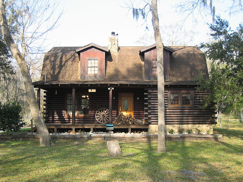

Dude, if you use nice squared timbers, on your corners, use the "butt/pass method. Then on the corners, drill a hole and pin the corners with rebar. Then spike the timbers as you go along. Here is a picture of butt/pass corners. Makes it a snap!
Butt/Pass corners
Butt/Pass corners

They pin them right through the center of the corner joints using re-bar. I'd spike them along the run just to keep it square and strong to carry the weight. There is also "D" logs you can buy milled, has interlocking bead to keep it in place, but still float for expansion. You can use the butt/pass method on the D logs too. They come grooved for wiring also.

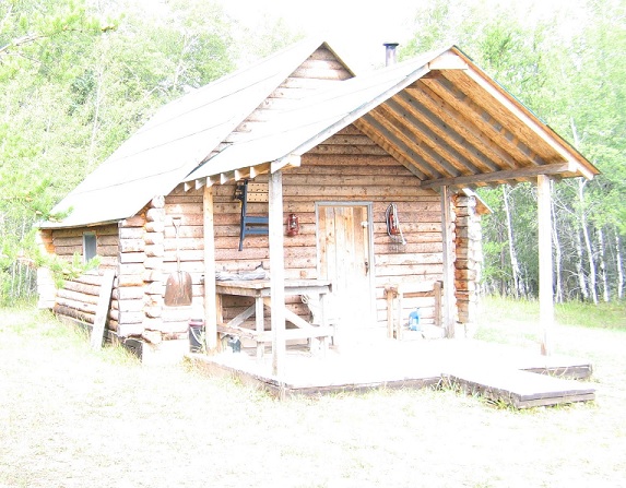

My father built a cabin just like this. It was many years ago and even though I helped its a little foggy. I will try and post what I remember!
He used a chainsaw to cut the groove and then inserted plywood. Then cut a groove in the next log and sandwiched the plywood between the 2 (in the groove on the bottom and the groove in the log above). He tried to make it a tight fit so it wouldn't be affected by shrinkage much. All this was done with rough cut, but dried timber. The plywood eliminated any chinking and kept things sealed up. The dimensions were 20X16 with a 1/2 loft.
It was built over 24 years ago and is still standing and being used today. Just to note, the loft has been abandoned for sleeping as it was just WAY WAY too hot with the wood stove. As with all lofts, you need to plan airflow and cross ventilation to make them comfortable.
I have attached a picture of the cabin about 10 years ago. Nothing has changed today except new shingles and some roofing boards.
