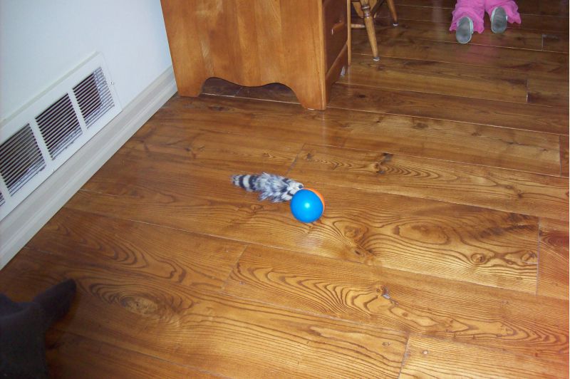

# Posted: 23 Dec 2011 11:04pm
  ash floor, screws and pegs, dark stain and poly

  Wow.  That is a beautiful look for a cabin.  And durable too.
  When my friend did his maple floor and my father-in-law did a southern pine floor they had to use various artifices involving levers and such to force the wood together but if the boards come back straight from the sawmill I would think that this would not be too much work with ash.
