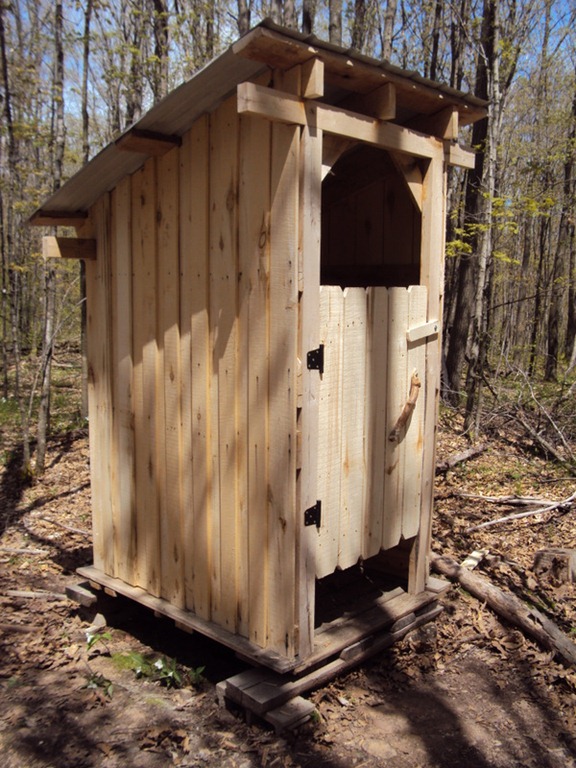

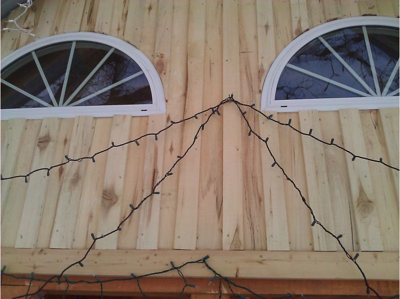

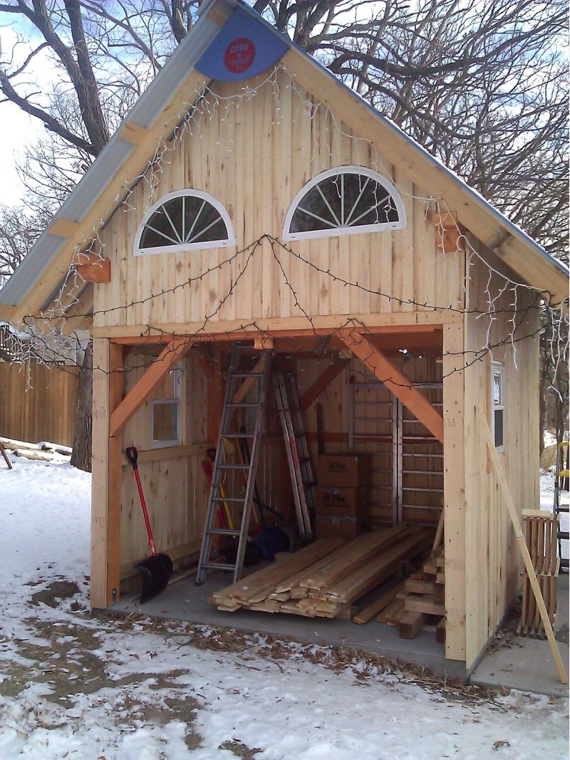

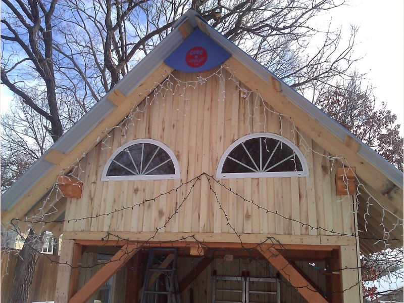

# Posted: 10 Dec 2011 10:35am
Here are some photos of unfinished board and batten. The outhouse at the Stump Ranch has no finish or stain, this is the second winter. Temporary structure so I probably won't ever put on any finish.
The Timber framed shed is board and batten, currently unfinished, only because it got cold and snowed before I managed to complete the building. In the spring, I will add colored stain so that this matches my house.
In both cases the siding is 3/4" (True 3/4 cut on mill). Boards are 6" wide and the battens are 3" wide. Stump Ranch Outhouse

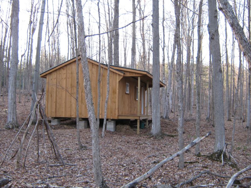

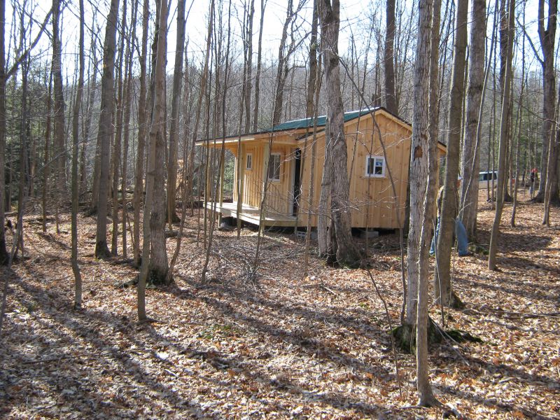

cman47c
# Posted: 12 Dec 2011 09:01am
