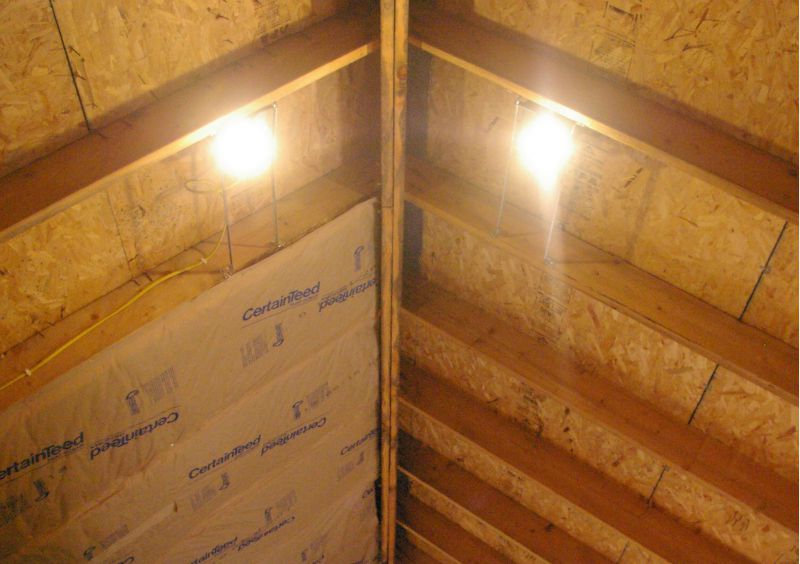

Found this picture of the double 2x10s before insulating and finishing the ceiling. I'll post a picture of the finished ceiling later.

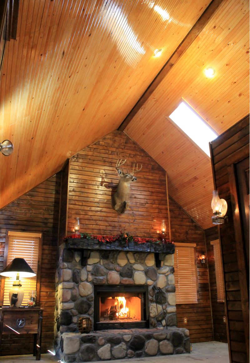

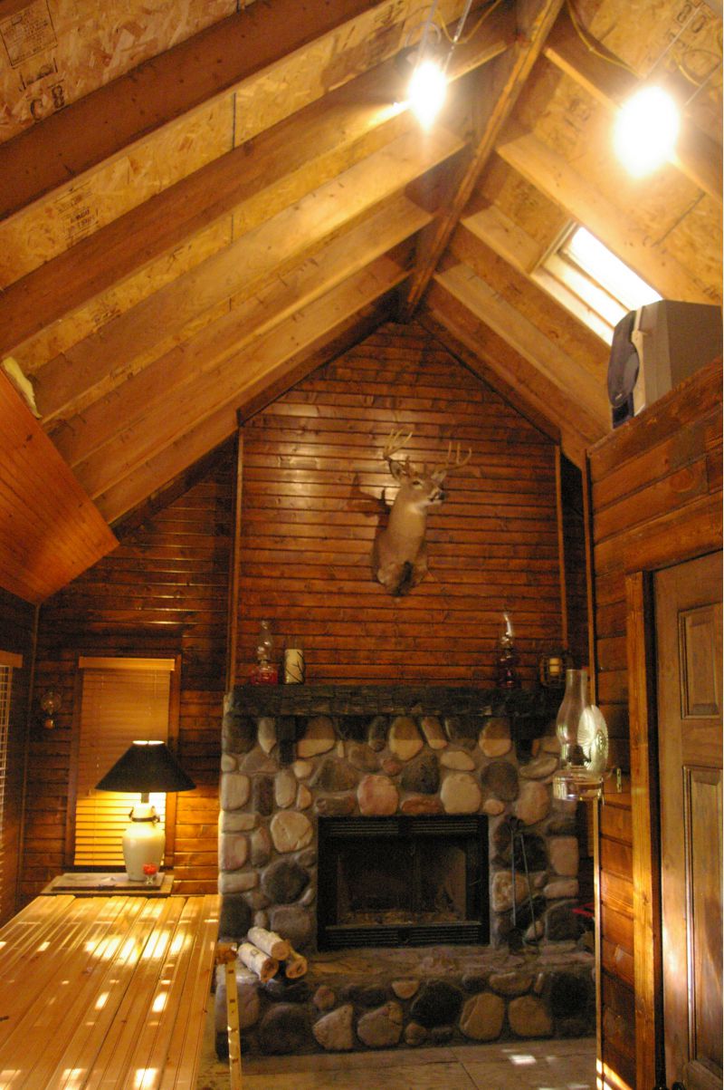

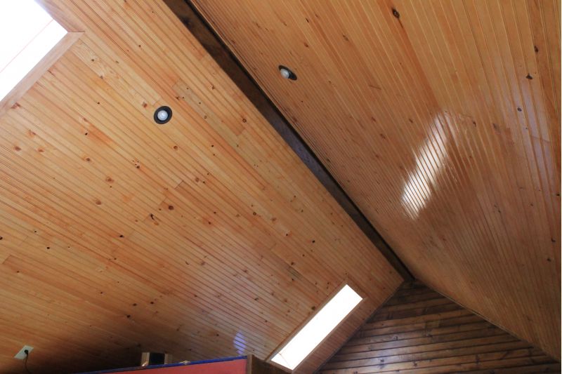

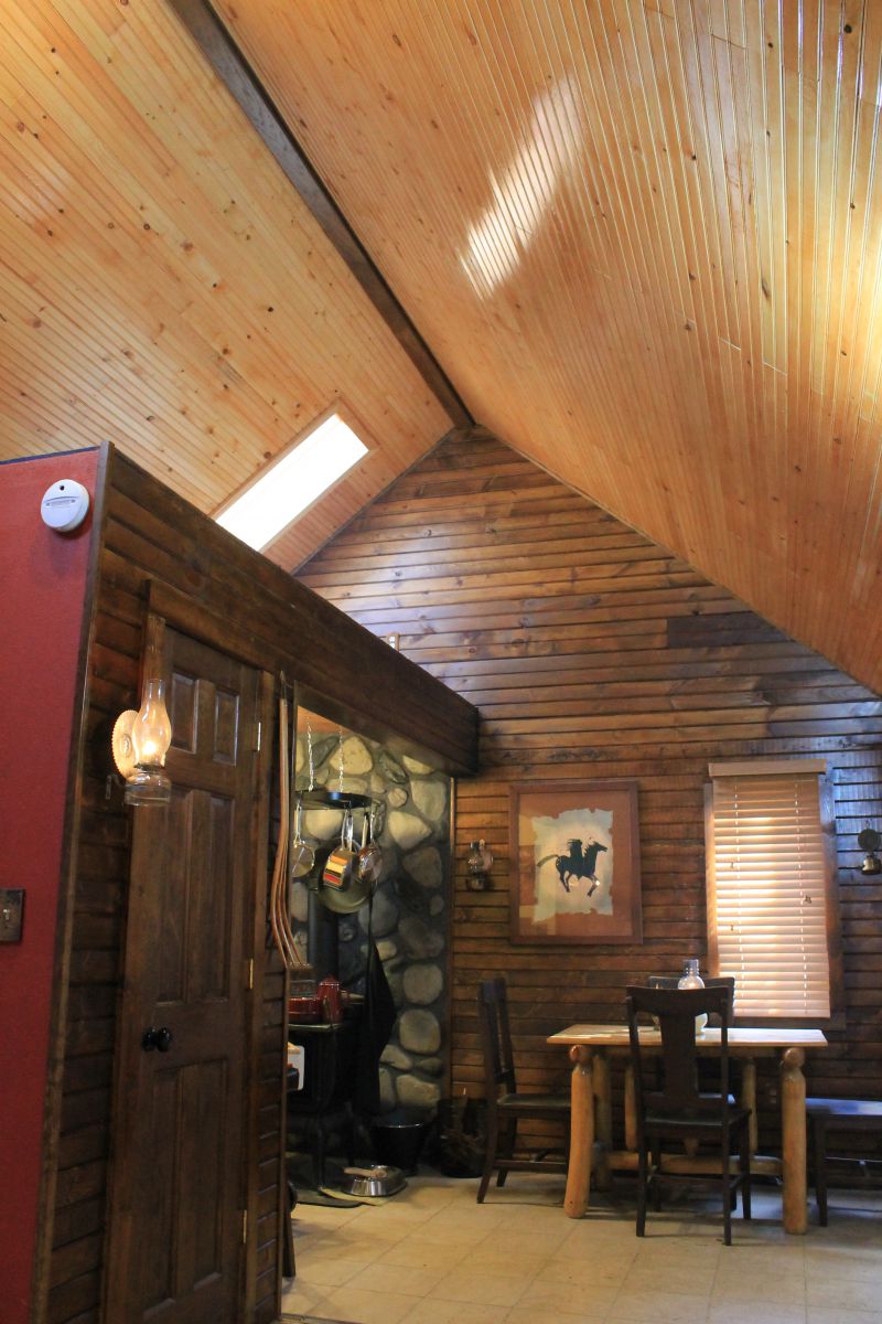

Here is my finished ceiling with my ridge beam capped with hickory.
cabin ceiling
cabin ceiling
south view
south view
ridge beam
ridge beam
# Posted: 18 Dec 2011 06:00pm
dfosson
Sure looks good. That is very nice.
# Posted: 18 Dec 2011 09:38pm
Quoting: neb
x 2
and the fireplace is awesome---and nice buck as well.

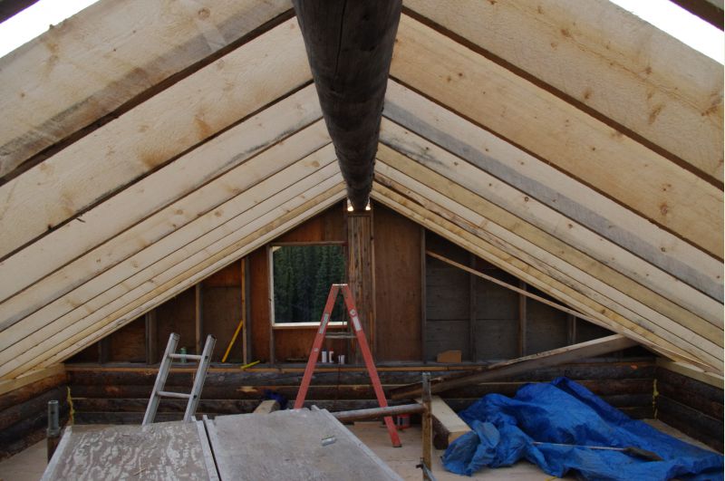

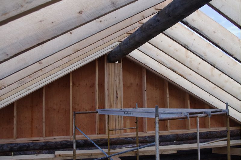

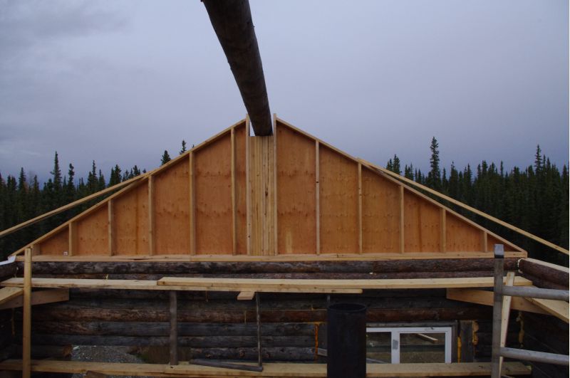

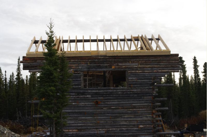

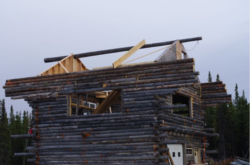

I did use a solid ridge pole but it is far from a show piece. I searched for many hours for the right fire killed standing dead tree, cut it down and towed it home with my snowmachine. It is 37 ft. long and about 13 to 14 inches at the butt end.
dfosson
# Posted: 29 Dec 2011 04:41am
Quoting: 45north
AMAZING! That's what I call a Ridge Beam. Did you use a helicopter to set it?! Very nice and impressive.
45north
# Posted: 29 Dec 2011 05:01am
Sorry, dfosson
I forgot to add that part. I built both the gable ends on the ground and I used an extendable boom fork lift from where I work to place them. It is about 30 ft to the ridge/peak.

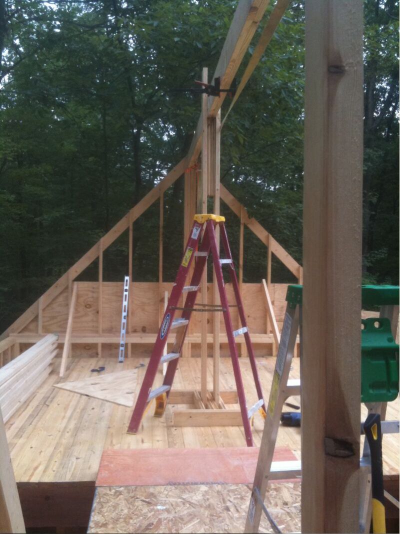

# Posted: 14 Jan 2012 10:08pm
dfosson,
I also used doubled 2x10 for the ridge. I came across a photo I took when I was in the middle of this process. I had to build a stand to hold half of the assembly while I fit the other half in place. That stand is still laying in the burn pile. The backbone may sag over time. If it does, my place will look that much more like a traditional Appalachian cabin ;) Thanks for posting all the pictures of your place. It's been very inspiring.
Ridge
Ridge
