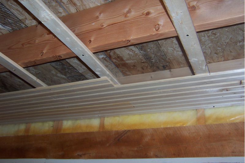

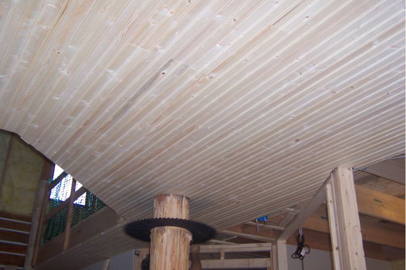

# Posted: 4 Jan 2012 09:53pm
Here are pictures of what we did for anybody who may be interested. We did put up 1x3 strapping to span the joist and then the T&G bead board.

# Posted: 4 Jan 2012 09:56pm
That's going to be nice.

# Posted: 4 Jan 2012 10:21pm
I like that alot, where did you get that bead board ?
# Posted: 4 Jan 2012 10:33pm
Thanks, It comes in bundles of 14 sq. feet at Menards Building Center. We bought it when it was buy one/get one free and they are $8.98 each normally.
