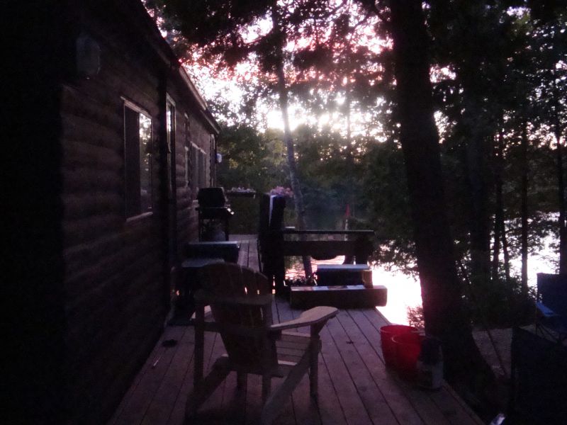

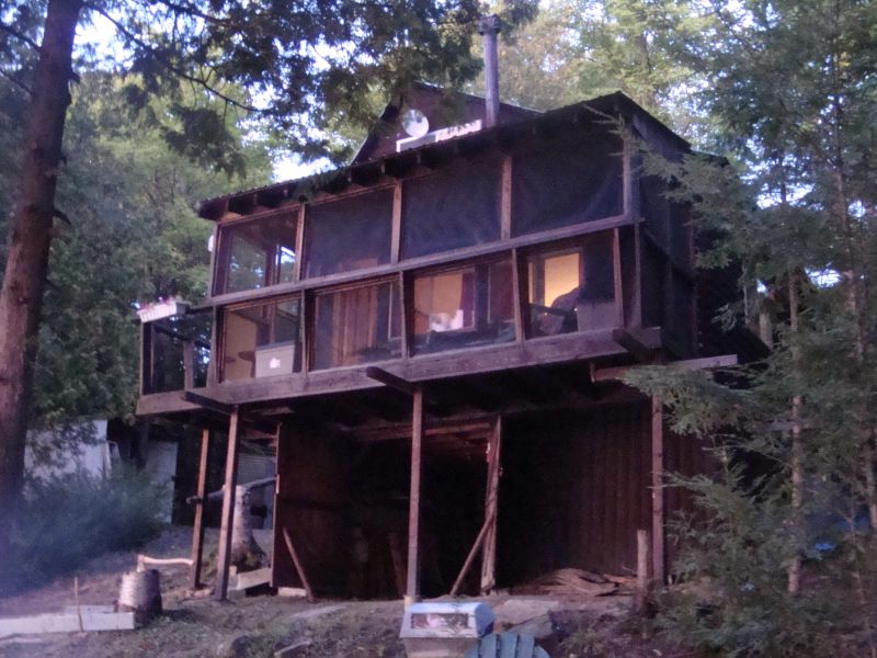

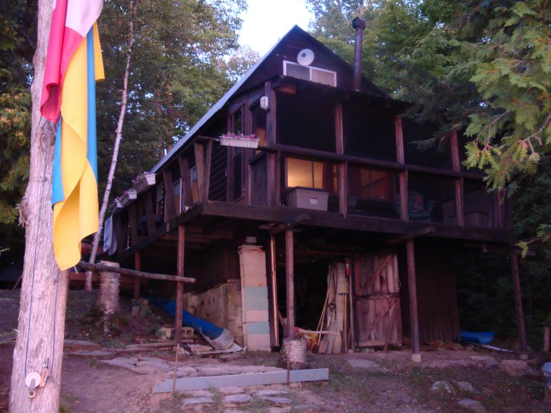

To make a long story short, I have a 3 season cabin, off grid, in Muskoka in Ontario. I just acquired it this past summer (bought off the original owner who built it in 1961).

I've attached a few pics of the cabin. No interior pics yet.
