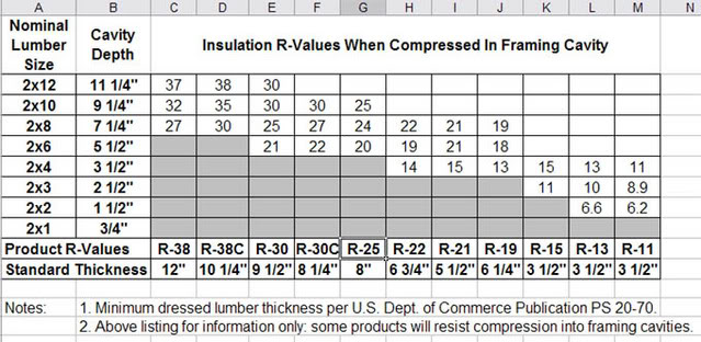

R19 fiberglass batts are rated R19 when installed to the manufacturer's rated thickness which is usually 6 1/4". Check the Owens Corning chart below. But 2x6's are 5 1/2, 3/4 of an inch less. According to Owens Corning that reduced the R19 to R18. If the fiberglass is compressed an addition 3/4 inch there will be more reduction in the R-value of the fiberglass. How much? Can't say for sure from the chart, but I'd say it's likely to lose another full R-value, maybe more than 1. So that means the fiberglass will lose maybe 2 points of it's insulating R-value against heat loss from the inside to the outside; coming in at maybe R17 inside to outside. ??? . The R-value in the direction outside to inside would likely be about R17 + 2.7 = R19.7. Perhaps this is worth all the effort as the R-value of 2.77 may not accurately reflect what actually happens on a day when the hot sun is beating down. I don't have the answer to that. That's a tad more than what you'd have without the radiant barrier.

compressed fiberglass
