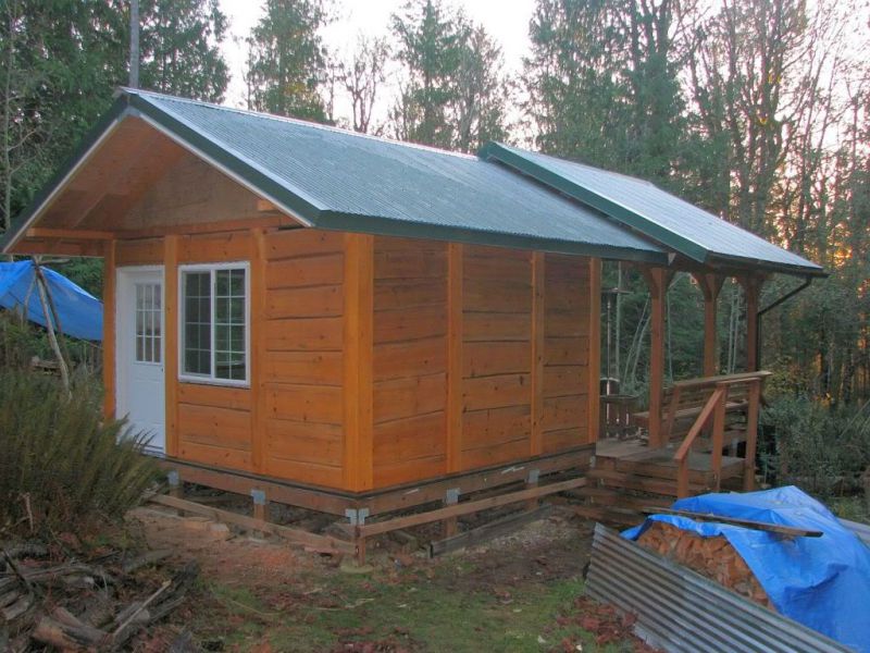

Here's another style of "log-look" construction. It's a post and beam with cut timber wall infills. Strong structure with clearly defined load paths. Post and beam log-look 1
|  Post and beam log-look 2

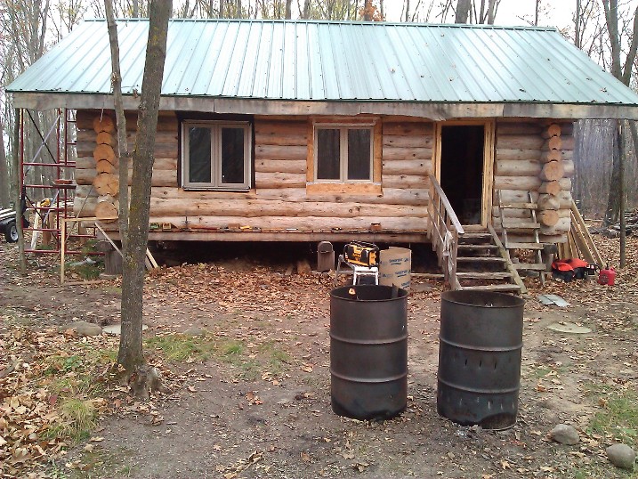

I built a log cabin. Cut down the trees and peeled the logs. Hand-scribed construction. This route takes a great deal of time.
I've seen a number of photos of the butt and pass construction you mention. If it were me, I would saddle notch and chink round logs rather than butt and pass. This method is pretty quick (fit up is easy, no messing with lateral groove). And,notching the corners gives you a little better stability as compare to drilling and pegging with rebar.
Another method that is quicker is dovetail and chink rough sawn timbers.
Settling is not a big deal, you just need to account for it and key the windows and doors. Here is an example:

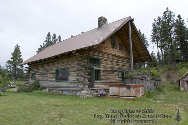

Here is one of the many examples of LHBA student-built butt & pass log homes, this one in Cle Elum, WA. cleelumloghome02.jpg

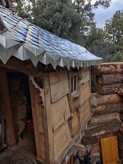

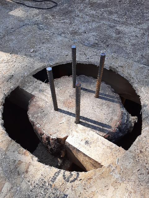

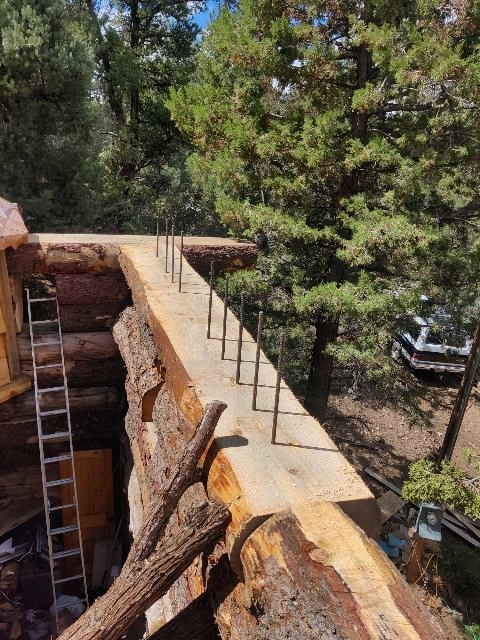

Put enough, large enough rebar in and you do not need to angle the rebar. The ribbed portion of the rebar acts as a lock the wood shrinks onto.
When first putting our logs on, we misplaced one of the logs over 8 inches and put one rebar through before we discovered our mistake, and used a rough terrain forklift to try to separate the 2 logs. Couldn' t do it, bent one of the forks too.
We are using 30 inch long #8 rebar, spaced about 14" apart, spiked straight vertically, every course. So if you were to make an x-ray image of the walls, every 6 inches or so, there is a 1" rebar running vertically. We have to use a power sledgehammer to drive rebar in pre drilled 7/8" holes through the logs. Each drive takes about 3 minutes.The log courses I cut to 16.5" tall. Most logs are between 3 feet wide to 2 feet wide(getting smaller going up) One course spikes straight line down center of log, next course layer spikes are alternated 3" off center, in a zigzag pattern so you don't hit the lower spikes.
We put the lowest courses on 2 years ago, each log (using mostly jeffrey pine we cut ourselves) shrinks a little differently, so the gaps that appeared between courses vary in thickness up to about an inch. There is calculated about 3500 pounds of weight on each rebar holding up the bottom courses of logs. Our highest logs are about 26 feet above foundation. You really do not need to go angled with the rebar.

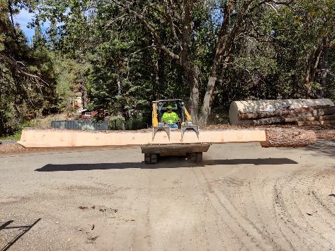

We have used 382 18' to 30' long logs for the castle build so far.
Recently, we talked with a random couple who were up skiing for the weekend and found out from someone in town (Big Bear Ca) what we are building. They came by our castle build to see another "butt and pass" home before they built their own. They said they had attended the Vegas LHBA course in prep for building their own cabin in montana. They taught all good things to know, but their nda agreements are solely to try to keep uninformed newbies to pay for keeping their seminar business bringing in $. They also actively shun anyone who does their own better butt and pass style, only interested in selling seminars to make money. I know, as a couple of years ago sent an email to their info site, with pics of our build, and got literally "never contact me again, or I will sue you" nasty voicemail claiming I "stole" his proprietary methods. Which is a joke as the origins of this type of construction originated with Santa Fe railroad engineers when they hit the rocky mountains to build giant retaining caissons to fill with rubble rock, as platforms to build their million pound trestles on, before Mr "Butt n Pass" was even born. It's a shame, as cult mind control techniques to try to keep power to make money off of newbies ends up only delegitimizing their companies good info message
Everything on our castle I and my wife have built by hand, and only the two of us, along with an antique crane are doing it. Poured the foundation 4 years ago. It is 4100 sqft of area, with a 400 sqft flat useable victorian style roof. The top turret finial will be 68" tall.
Oh, and the "easier way" to get logs for FREE! is to contact all the tree cutting companies in your area to drop off the logs closer at your milling staging area, as it costs them less for driver time and diesel if they don't have to drive an hour away to dump. Also, talk to any commercial log truckers hauling cut logs they are taking to the chippers, and voila, for a case of beer, the load is yours. We got half our logs from San Bernardino County fire mitigation that way. rps20201203_084606__.jpg

Artmodels
# Posted: 26 Oct 2022 11:23am - Edited by: Artmodels
Reply Quote

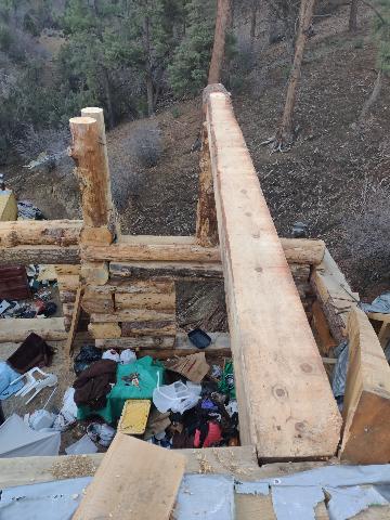

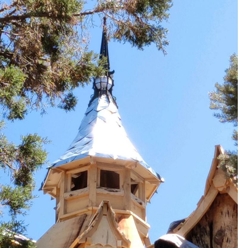

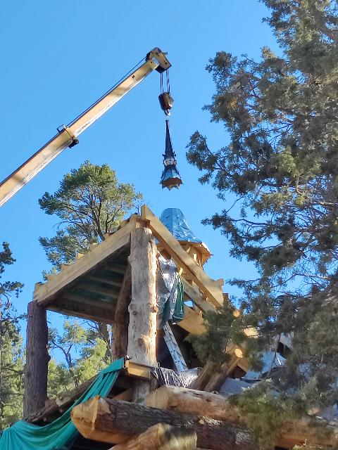

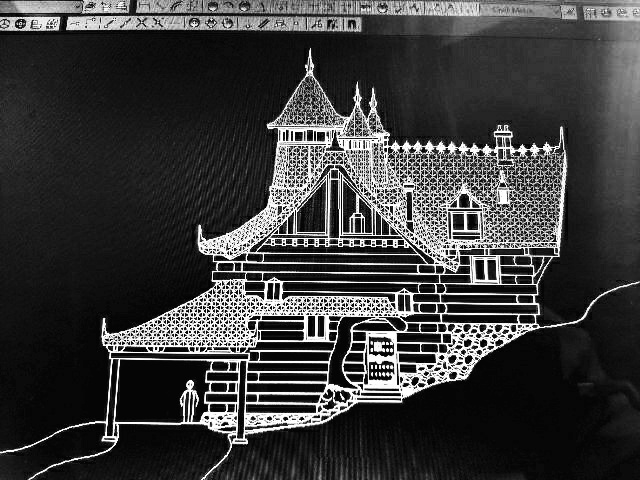

More pics
Different construction details. The main beams are 30 foot cut on three sides to 18" wide, 24" tall rps20211118_083024.j.jpg
