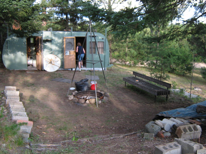

neat old cabin trailer ---
looks like you have a few ---conc test cylinders'///- :- )) they do make great retaining walls.. :-)

Thanks, test cylinder you say? Please explain we were wondering what those were used for.
# Posted: 7 Jan 2012 07:06pm
when you work on a gumberment :-)) --federal construction job, you are required to make a test cylinder ever so many yards of concrete. They let in set for 30 days and do a test /break on it. A load PSI test on each one.They weigh 33 1.3 pounds each +/-.......but make a great retaining wall.
