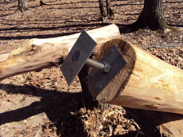

I have a similar issue being remote. I recently decided to add a porch to the Stump Ranch. For porch footings I used a simliar technique. I cut 18" diameter sonotube into 6" sections. Then, I dug down a few inches and leveled out the tops of the sonotubes. The final step was filling the sono tubes with sack-crete and a little rebar. Pretty quick operation, I did the layout, setup, and pouring in day.
When I set the posts, I will use screw-jacks (photo attached) in the bottom. You drill a hole in the bottom of the post and install the screw. This will allow to me to account for any frost heave in the future.
Here is a link to Schroeder Log Home Supplies where you can get screw jacks (and other log home supplies) http://www.loghelp.com/p-1831-screw-jacks.aspx
Or, if you can weld, just make them up with plate steel and all thread.
In my case, I will just put a couple cement screws into the jack to keep in place, the weight of the structure prevents movement. If you wanted to ,you could set the base of the jack right in the pad when you pouring, which would probably be a more solid installation, just make sure you are plumb.

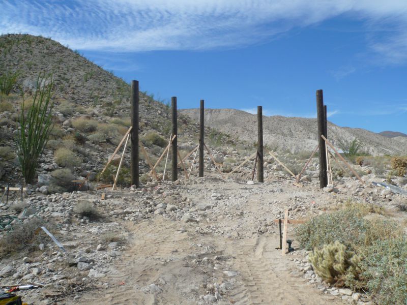

I'm building a pole cabin and being a General Contr. as well, I would recommend having the posts go into the ground instead of sitting on top of it. And why not go with actual poles instead of posts? 6-8" diameter would be fine. And I found this book more helpful: http://www.amazon.com/Cost-Pole-Building-Construction-How/dp/0882661701/ref=pd_sim_b_ 2
# Posted: 8 Jan 2012 04:07pm - Edited by: MtnDon
I agree with Borrego. One of the advantages of pole buildings is that with the poles set several feet in the ground the building is anchored and the wall structure stiffens the walls and ties everything together, Sitting on the ground the building has no uplift / tip resistance other than the weight of the structure materials and contents. That's not always enough when the wind blows 85-90+ MPH.

# Posted: 8 Jan 2012 10:54pm - Edited by: Borrego
No, you don't need to use concrete, it may even be a detriment (holding water, etc), just soak the poles in diesel fuel or something. The ancient structures were just sunk into the earth. Your cabin is so small, you'll be fine.... and use some diagonal crossbraces between the poles to stop them from moving. My cabin is so solid it amazes me!
