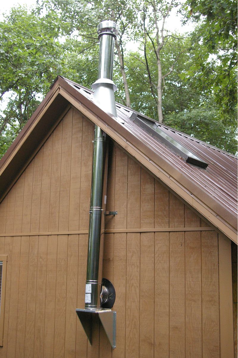

I've posted my wood stove chimney picture; there is no down draft and this is the end of the house that catches 90% of the wind out of the southwest. I'd put another section of pipe on it.
chimney.
chimney.
