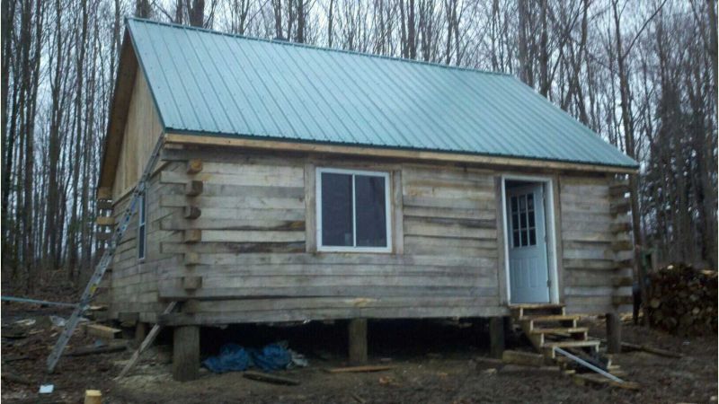

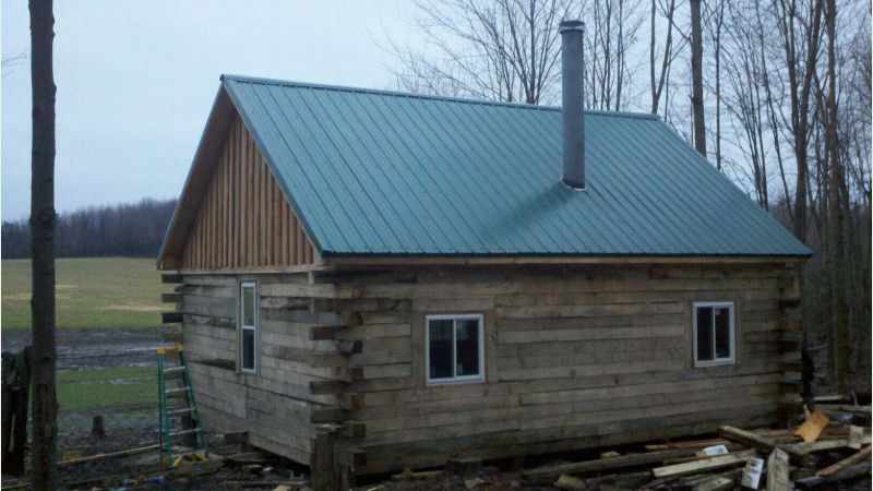

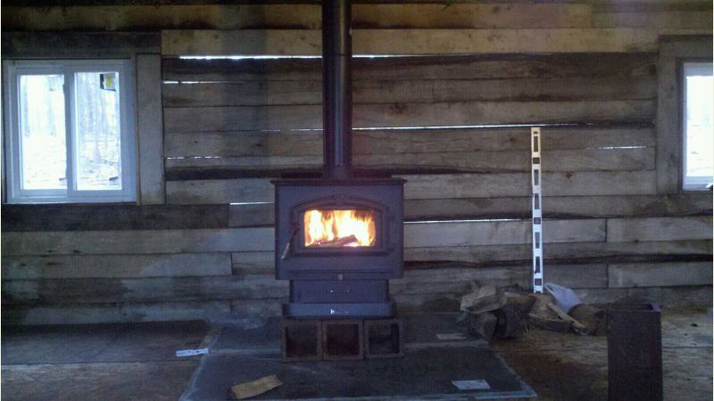

Hello, I recently built a 24X20 log cabin and I'm considering insulating the inside walls. The metal roof already has double bubble insulation. I was thinking about putting a plastic vapor barrier on the inside with fan fold insulation. The walls are 6X6 butt and pass logs that I cut myself. Any ideas would be very helpful. Thanks. cabin1.jpg

I bet you have already gotten around to it, but looks like you haven't gotten to chinking yet. That should eliminate some of the draft.

I don't really know why you would need insulation on the interior walls once you have good chinking. Our 22x26' cabin is log and I have been incredibly impressed by the insulating ability of the logs (though it takes a while to get them warm, of course.)
