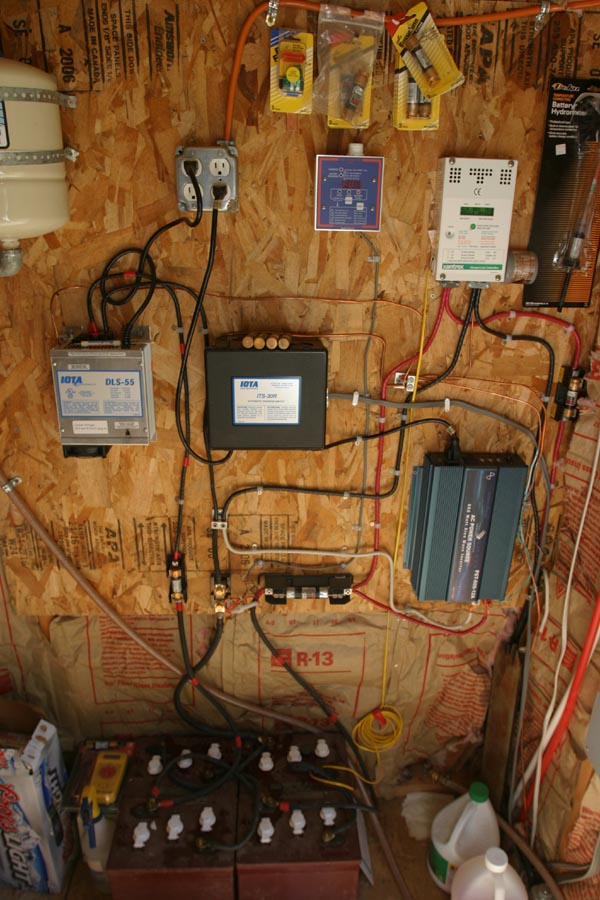

Other than power tools, or other high draw items, you can run most of what you want off your batteries full time. I doubt you will want your generator running very often. Plus you have to haul gas.
How is your sunshine, winter and summer? We have 7 hours of very weak sun in the winter, 13-14 hours of strong sun in the summer. My cabin has four T105 batteries, and will run two buildings with about 35% of my battery store per day in the winter, 15-20% summer. My buildings are setup wired entirely AC, and the battery's juice runs through a 1750w inverter. I have two 135w panels (I think), they run through the charge control box, and charge the batteres. in the winter, when solar charging is weak, I throw the generator on for a couple hours. I have a Honda EU3000 generator.

First a question. Are you going to have some things like lights run DC? Many people do that but it is my opinion that DC and AC together just complicate things. I have similar to wakeslayer; our cabin is mainly 120 VAC with only a couple lights on 24 VDC. The DC lights were purposely used so we would still have some light if the inverter crapped out. It probably won't ever, but this was just in case.
To the question of "flipping the switch" between solar and gen. A good inverter/charger eliminates the need for that. They cost more but they make life simple.
You can also get a stand alone automatic transfer switch. The power from the inverter connects to it. When the generator is started the ATS will automatically switch from the inverter (solar) power to the generator. There are also manual transfer switches which is likely the device you mean when you state "flipping the switch".
