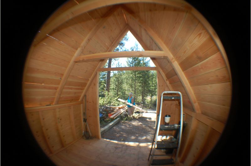

# Posted: 15 Sep 2009 11:15am
dear Brian,i do not know but that roof business gave my hubby nitemares as we are in a really heavy snowload area.so here is what he came up with.cabingal3

Don't use engineered trusses, build a gambrel style roof for more room up top... Just my.02
