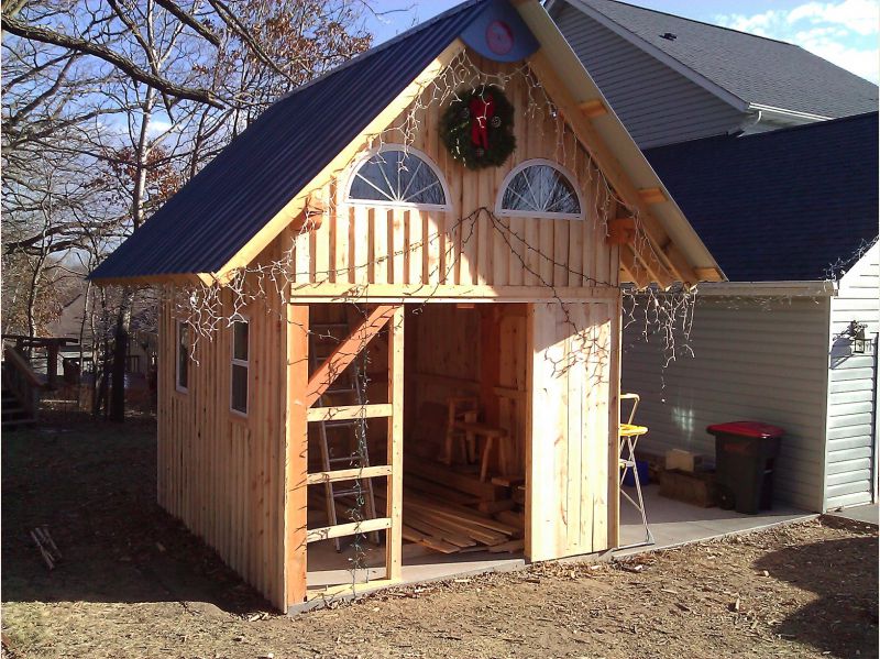

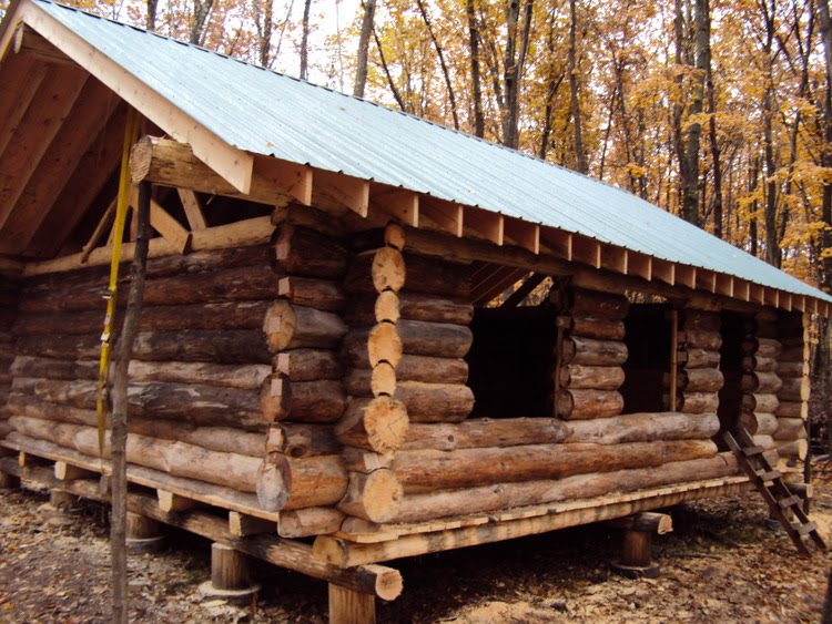

Purlins with metal work fine. Make sure you vent the rafter and soffit space. If your venting isn't proper, you will get condensation and/or ice dams with either OSB or purlin set ups. .
Purlins are cheaper and quicker. Plywood/OSB gives the roof a little more strength (especially if you have to get up on top of it).
Purlins and Metal
Purlins and Metal
Plywood and Metal
Plywood and Metal
