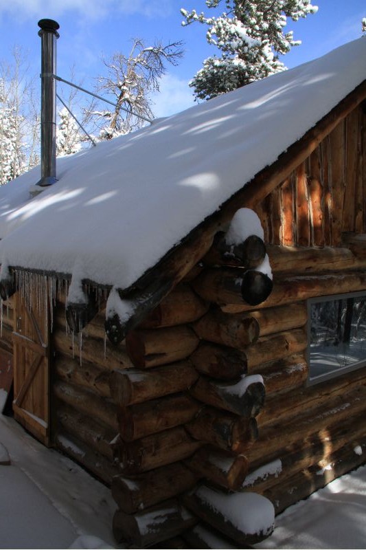

Here's a pic of my cabin. Notice the corners are a pile of logs, then notice the porch roof has a vertical log. There is a screwjack under each post, that allows me to jack the porch roof down to follow the cabin down as the pile of logs settles (shrinks).
Stack of logs cabin
Jacks are the 'normal' and more reliable solution but I would have enforced the old-school and more troublesome option. I was away from the project while this detail was being solved and would have chosen removable shims under the porch posts.

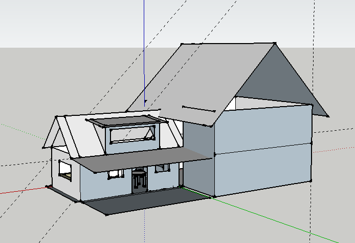

Thanks for the post Tom, here's a couple pictures.
As for what you have said above, The cabin was built in the late sixties the old fashion style, which is how I am going to build the addition. I think any settling that was going to happen already has so that shouldn't be a concern. For the addition however you are completely right, the settling will be an issue where the two structures meet.
As for how I was going to deal with that my only solution was to use posts where they meet, say if they meet at a corner, to cut the tails of the logs (on the old cabin) so the are plumb and flush - perhaps taper them so they look as if they are sitting in a channel in the post - then for the addition side have the walls actually be built like that to allow for the settling.
My concern is if one corner is built like that, and the rest are coped I would assume more settling could occur there than at a coped corner, which would then wreak havoc on the roof..?
The picture you posted does look nice though, and would be less work I suppose. Although the two styles wouldn't really match, it may be the only solution.

Sorry I don't think there is any way you can join these two structures and have it look anything other than a big new addition tacked onto a small log cabin.
Once a building gets that big and expensive you'd better avoid any upcoming foundation problems that the old cabin might contribute. If you're asking *me*,,,,, I would build the new one to look as classical as possible, but accept that it's different, and keep the two separate, maybe consider an enclosed breezeway that's easy to maintain (or a deck) connecting two separate buildings? Just an idea.... It's my opinion that small cabins have a certain appeal and look. You have to completely erase the small-cabin aspect or it looks like a big add-on. Just my opinion, of course, biased heavily towards 'small' cabins.

You could use piece-en-piece constrution (similar to the first photo Tom posted above).
If you just wanted to use posts adjacent to the current building, just slot the posts and and put tenons on the log ends; then, you can notch the other corners in a traditional manner. Everythng will settle together.
I would not join the roof structures between the new and old, settling will make everything out of whack.
In my opinion, the look of the large add on, doesn't blend well with the small cabin. I, too, think a seperate building might be the answer. Dovetails, timber frame, piece-en-piece, or log would all compliment.

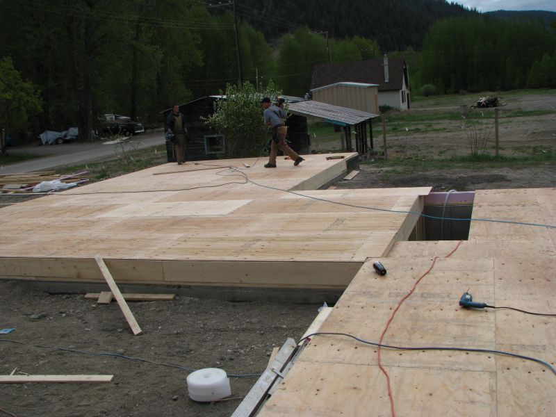

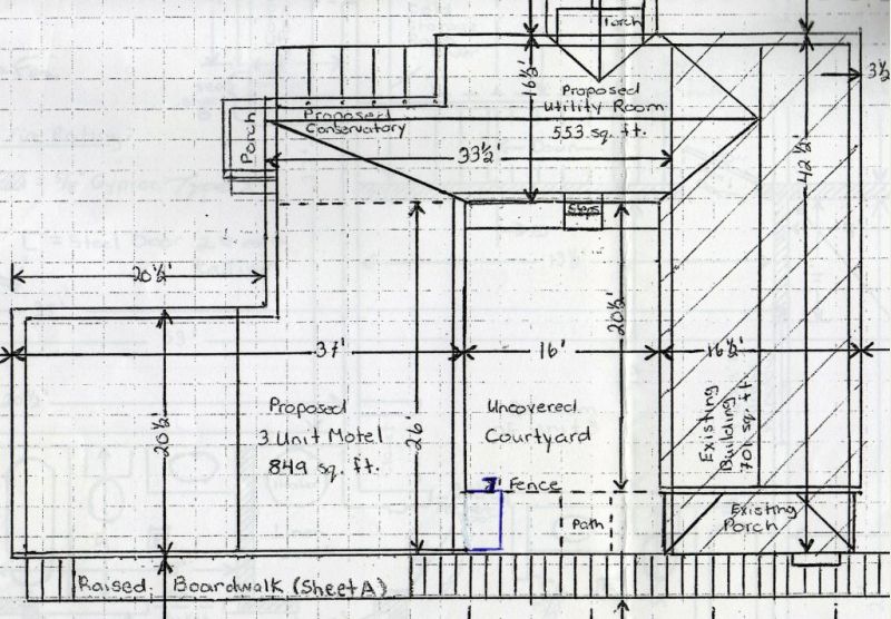

We put an addition on our 1912 cabin when we decided to live here full time. Our original cabin is 14' X 36'. We didn't want to disturb the integrity of the historic building, so we put an addition on the back where a small room (our bedroom) had already been added.
What used to be our back door now leads to a large utility room/food storage/clothes closet room. This leads to a greenhouse and the greenhouse also leads to the big addition we put on for our motel. By adding this way, it left a beautiful courtyard area between the old building and the new addition. I hope the design plan below is understandable. The old building has the diagonal lines through it on the right. The addition is to the left of the original building.
The second photo shows when we were under construction. You can see the layout of the floor in this photo. The hole that you see became a stairwell to our coldroom which is under the greenhouse. The layout is pretty unconventional but it sure worked well for us.
