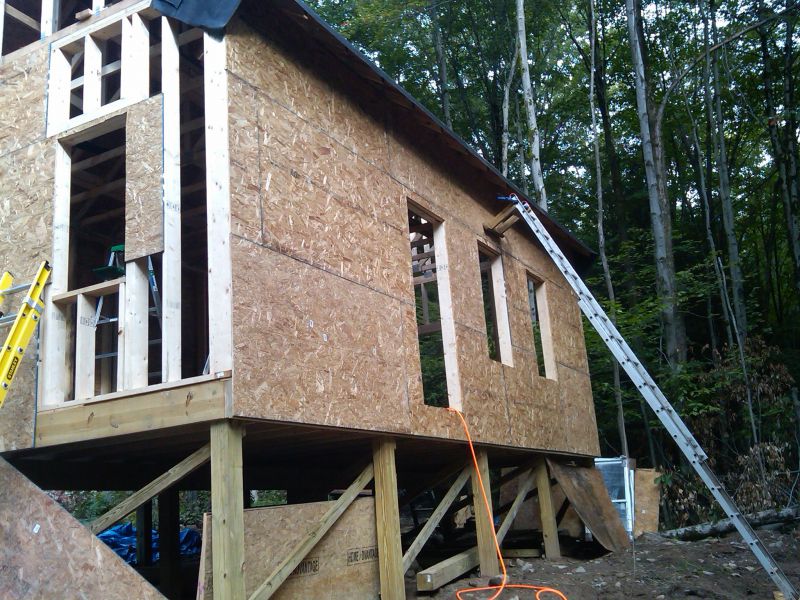

Don, great break down of the options and what to look for! When my building inspector came out in my area he said if you are above 2ft from the ground I had to cross brace the 6x6 together and then back to the middle posts. PT 6x6 was a cost effective means of creating an appropriate foundation for the camp because poured concrete and block would have placed me well above budget and thought it would be alot more challenging leveling and placing the block. I placed the 6x6 closer together as well as used wider floor joists so that if I decided to add a second level at a later date I could do so without doing anything to the foundation.
