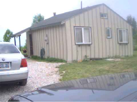

built this one in ontario can.in 2000 it is 24 x 24 with slab on grade + a rat wall as you discribe it. takes 2 days to warm up in the winter ,otherwise worked out great. developed 1 crack after 5 years we covered it with laminate floring.if i was doing it again i might do the foam thing as don sugests.I scraped off the first 6 in . of soil first [it was clay] formed it up with 8 , 2 x 10 x 12 ft spruce [which,,i later used in the building].then piled some spoil around the foarms then doug out a 16 in x 8in deep trench aroung the edge + a bit in the center where i had a support beem planned . then brought in a truck lood of packing sand to bring the floor in the center back up to within 4 in of the top of the forms.had no inside forms just tappered it down into the footing edge .watered and tamped the sand . this left the forms 10 in higher then grade, I then installed my pluming and water lines . then i poured 12 yards of 3500 grade cement with fiberglass reinforcement in it. no steel . then a pt bottom plate and the rest of the cabin .. took me a week by myself plus two teenagers the day of the pour. it pasted the building inspector and for me was the cheepest way to go. I have since sold the place but was by last week and its still standing CCF02012011_00000.jp.jpg

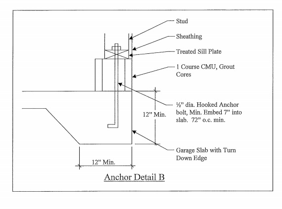

https://www.stpaul.gov/sites/default/files/Media%20Root/Safety%20%26%20Inspections/DS I.Bldg_GarageRequirements_0.pdf
Where I'm building there are many cabins and such on similar and thinner slabs even. One I'm familiar with is about 4-6" at the edges, uninsulated. Been fine for 10 years so far. BUT, local soil IS sand in that case.

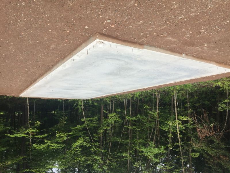

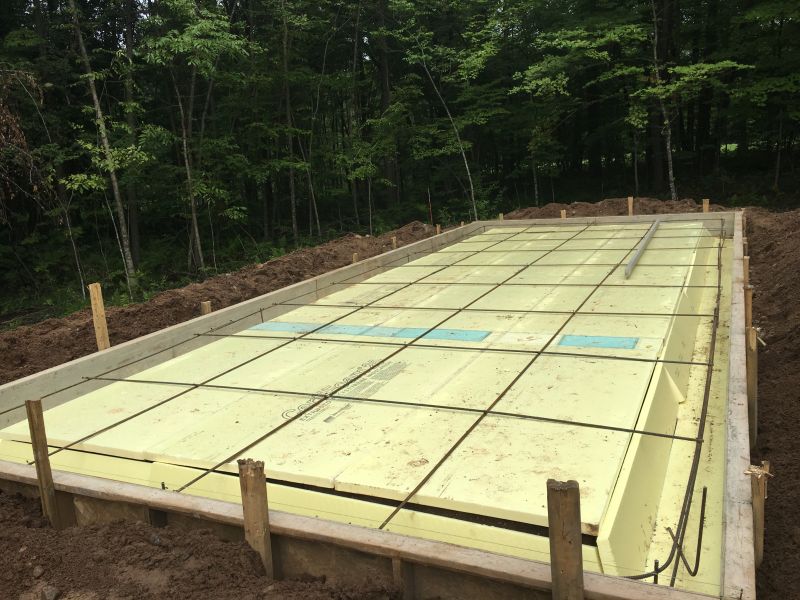

I had a 15 x 36 slab poured last fall for $3600. (After a cash discount.) This included 2†insulation underneath. I have an 18†perimeter “rat wallâ€. I intend to hold all of the door openings up 1.5-2†and use Amdry or similar insulated sub flooring on top of the slab. They did not put in perimeter insulation extending out for a true frost protected floating slab but I may still do this.
This is in central Minnesota. The soil is clay and the topography is level so the drainage was not the best. I had an excavator remove all the stumps from the trees that I cleared. They scraped down the top 12†of organic soil. Then they hauled in and compacted 24†of class 5 to give me a solid and well draining foundation site. The excavation work was $4000.
I hope to have the place framed this summer. Insulation and rebar
|  Finished slab
# Posted: 28 Apr 2019 02:55pm
That is a very nice start to a solid cabin. Looks great!

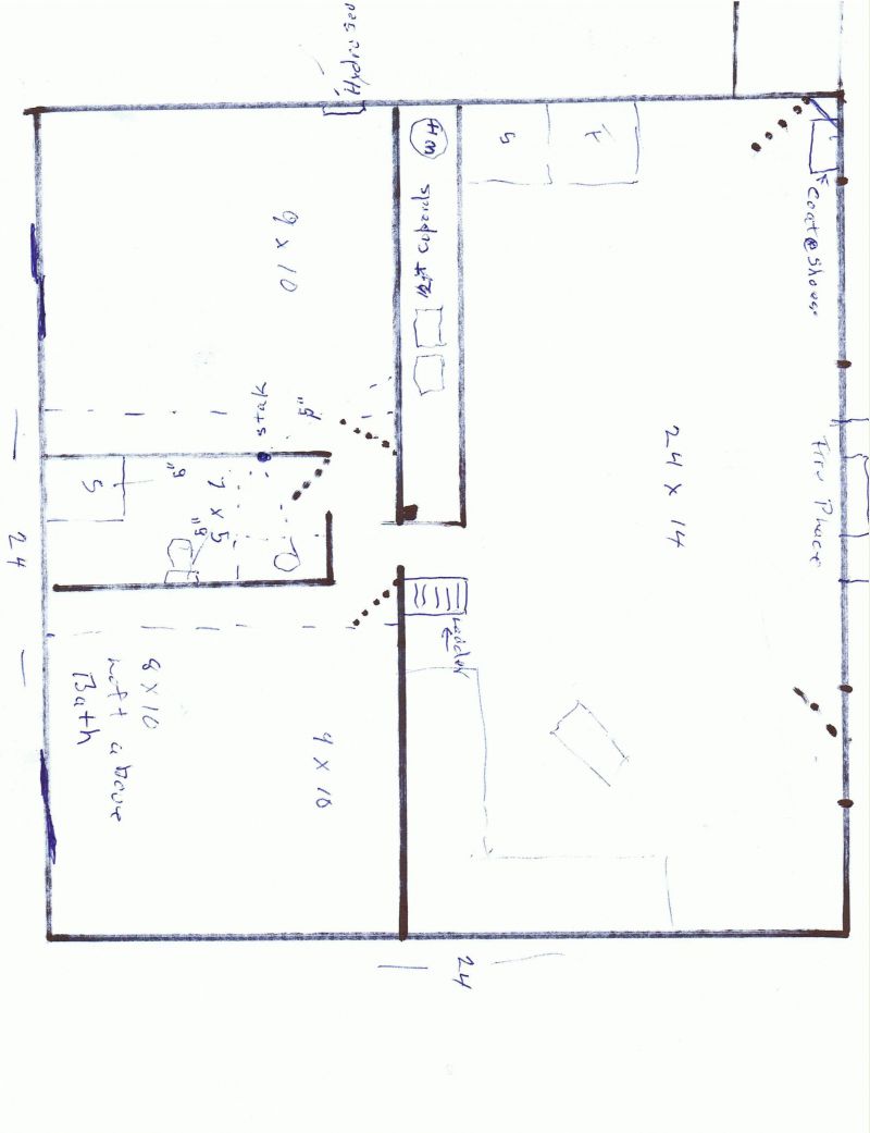

Nate R- I have read a few of your posts and I think we have similar visions.
I don’t have any formal blueprints. The county only needed a floor plan and cross section elevation for the permit. I was able to draw them myself with some graph paper. I figured the more vague I was with the county the less I had to worry about showing them changes as my design evolved.  I’ll start a new thread about my place sometime this week and we can have those discussions there rather than side tracking this one.
