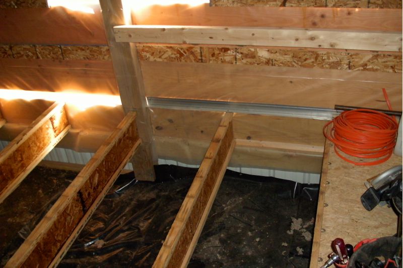

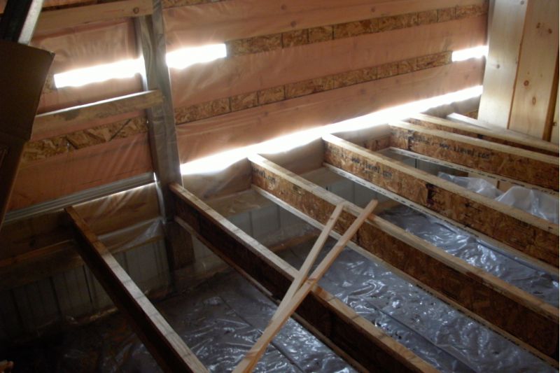

# Posted: 2 Apr 2012 08:29am
  I might be to late for my suggestion but what I did was build my cabin without a floor.Once you have 4 walls and a roof you can add the floor in later.I used those wood laminated I-beams for my floor joists.The lower part of the I configuration gave me 2 ledges to cut and lay a piece of OSB in and screwed and glued it down than calked in all cracks.Makes for a completelly sealed barrier to bugs and critters.You also can do it from up above the floor.No need to crawl up underneth the cabin for anything.The subfloor material is 3/4"Advantech brand T&G osb.I left the last sheet out to blow in cellulouse insulation into the 10 " cavity than layed the last sheets in.It's worked out pretty good.A little more pricey but It was well worth it.

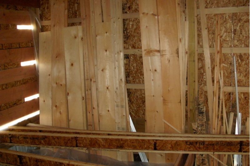

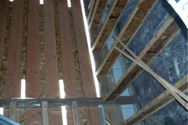

# Posted: 5 Apr 2012 06:05pm
  Here are some pictures of the unfinished part of my cabin showing the wood I-beams.I cut a piece of osb and lay it down on the lower ledges.Screw and glued down,calked seams.The Advantec sub floor allows me to go 24 inch spacing between joists.Good solid floor.The cavity under the floor is about 18 inches above the ground which is covered with 6 mill plastic sealed tightly(to keep the moister out.)The beams come in 10 inch and 14 inch wide.I went with the 10 inch because they are supported at a 10 feet span.Gives me a 10 inch cavity to blow insulation up into for toasty warm floors,too.  laminated_wood_floor.jpg
