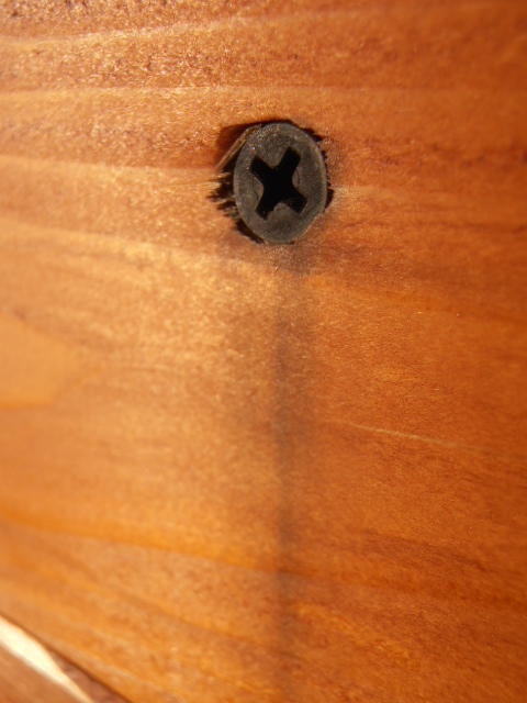

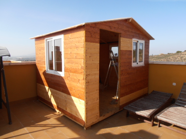

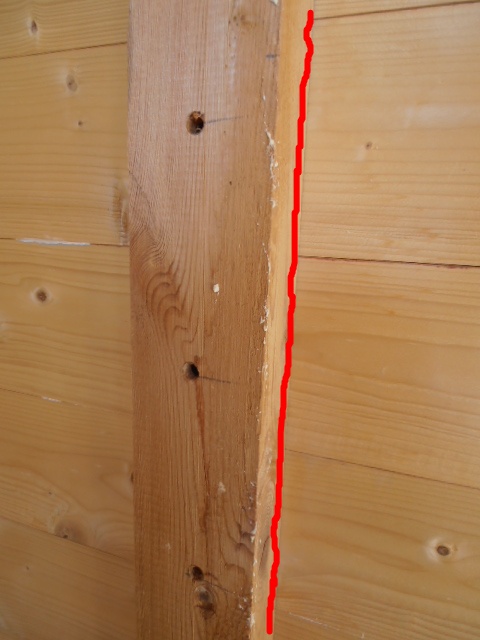

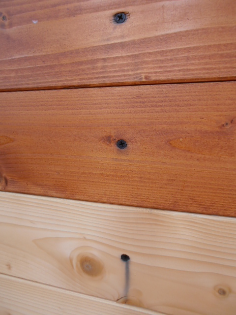

Hi - busy weekend with ill baby, finally got some time to post photos.
The first shows the cabin as a whole, and the red on the last indicates where I saw dampness on the studs.
As you can see from the two photos of the screws, the black colour is staining the wood, so I may end up changing all the screws.
I had a thought. 4mm holes were drilled in the T&G for the screws, so they are not tight fitting, except at the head. If I replace them with wider screws, might this help?
Where the cabin is tight against my balcony walls, I screwed them to the studs from the inside. Those are the countersunk holes you can see in the inside photo. I countersank them a fraction too deep though, as most of them just broke the surface on the outside, possibly letting water in? For these ones, I'm considering taking the screws out, squirting something (silicon?) in, then putting the screws back in.
Any other thoughts or suggestions well appreciated

# Posted: 25 Mar 2012 09:48pm
I don't think the screws that were driven from the inside are the problem, even through they did over-penetrate a little. Looks like the problem is the 4mm predrilled holes in the T&G. I think the screws driven from the outside and attached to the vertical board seen in the "inside" photo are letting some water in behind that board. You will probably want to pull all of those out, one at a time, fill the hole with a sealant and replace the screw with an exterior screw. I would look for screws that are recommended for decks and avoid screws recommended for drywall. Fair amount or work, but it shouldn't cost too much. Good luck with whatever you decide. Cool little place.
# Posted: 25 Mar 2012 09:58pm - Edited by: neb
You need galvinized screws that is why the bleeding is happening.
# Posted: 25 Mar 2012 10:21pm - Edited by: MtnDon
To prevent the streaking you need a coated deck screw like the ones that are made for PT wood, or stainless steel. The gold zinc plated deck screws will also steak after a while.
If you use a sealant in the hole and insert a new screw the potential problem I see is that the sealant may squeeze out around the head. That will then be visible or affect how the wood weathers and/or accepts any finish product.
The best screw would also have a smooth shank near the head that is long enough to pass through the T&G freely and then threads after that. Screws like that will cinch the T&G down to the stud best. The smooth shank should be a little larger diameter than the holes you drilled. 4 mm is about the size of a number 7 screw; a number 9 would fit tighter. You might have a problem getting the length you need to prevent the point from driving through. You could always strap a piece of 1x material onto the inside of the stud for more thickness.
Screws through the thicker stud and into the thinner T&G is not a good idea.
A solution that would be a tremendous amount of work would be to remove all the T&G on one side of the building (one side at a time). Then apply a strip of flexible window flashing like Grace Vycor Plus to each stud face. Then reapply the T&G. The Vycor is a rubber material that will seal the screw holes. The narrowest it comes is 4 inch so you'd have to split it. Kind of a messy sticky job. There are other brands but Grace is the stickiest in my opinion.
niceboy
# Posted: 26 Mar 2012 08:17am
Ok. I've got some 5mm zinc coated screws, and plan to replace all exterior screws with a little sealant in the hole. Any thoughts before I go for it?
The T&G was only screwed from the inside where necessary due to the proximity of the balcony wall. Hopefully these are not causing a problem - over-penetration was by 0.5-1mm only and not on all screws. However, some of the dampness was seen on the stud shown in the photo, which has been screwed from the inside. With luck though, it was running down from above, where the screws are on the outside.
