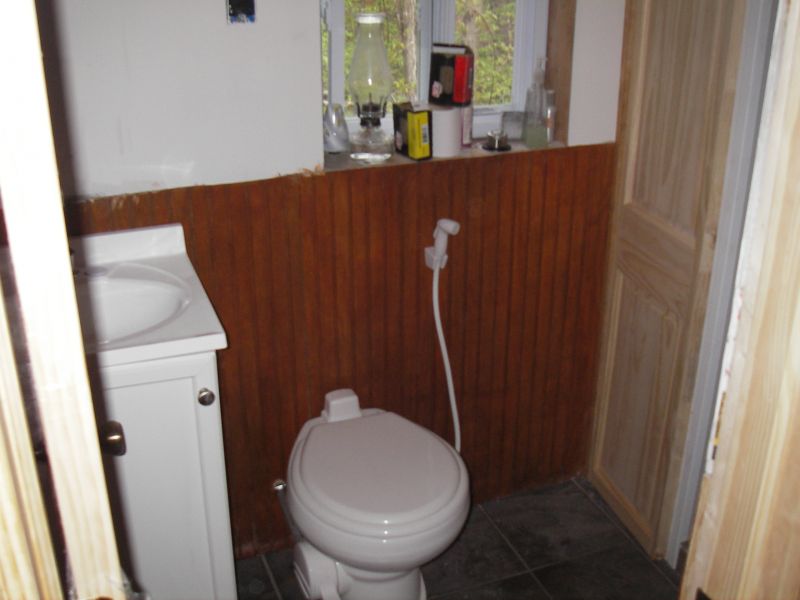

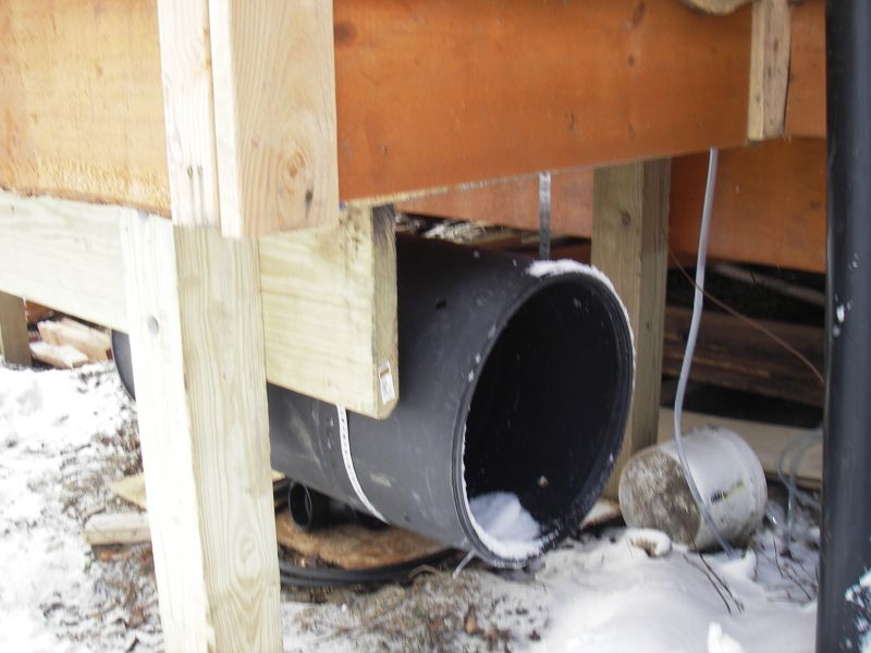

Never saw that link before. Here is a pic of mine before I completed it. The liquids go to a self contained evaporation bed, while the solids go to the rotating black 30 gal barrel under the cabin that is capped with the black pipe to the right for venting and partially filled with sawdust/peatmoss to speed composition. This is the same principle used in Sun-Mar and other brand composting toilets. The best part is that we get to use a flushing gravity toilet meant for RV's. So far it works beautifully for a family of five! Composter before finished
|  Bathroom almost comlete
