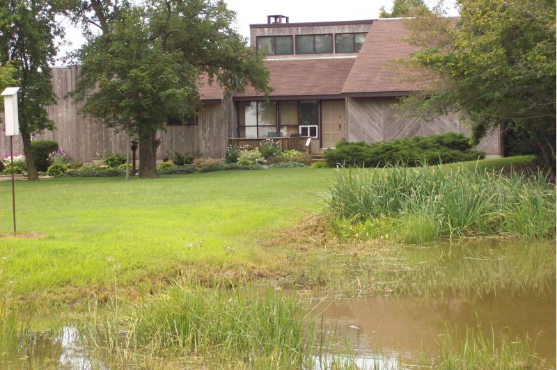

Our home of the last 35 years is all western red ,,as you can see from the pic i should not be giving advice . we try and redo the place every 6 or 7 years as you can see it's time to get to work.. i think this summer i will hire someone younger to do the ladder thing .the only way to keep them strait is to keep stuff out of the sun or have it nailed down .on the whole house i have one board that has a bit of a twist, wastern red is good stuff .
