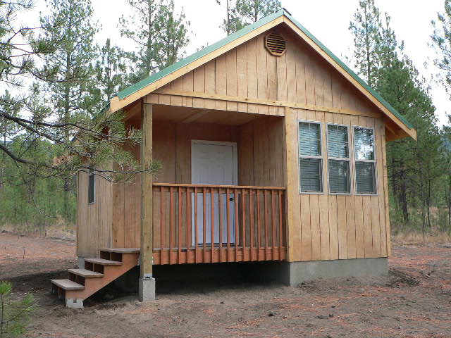

ElPaso, hey, I'm a handy builder, but never pulled a permit. I bought some plans online from http://www.townandcountryplans.com and did my site plan, submitted by plans, they OK'd it (I had to get an address too). I become the general contractor. I did sublet out the foundation, and the metal roofing. Otherwise, I did pay a friend who is a builder to help me frame it all up. I'm in it about $12,000 and its unfinished inside. I own the land outright (20+ acres timberland) and have been saving for this cabin and not knowing how much it was going to cost, I save about 4 times more than I needed. It took my buddy and myself 9 days. All I can say is, he was meticulous on plumb, level and square. I mean a 1/8" off was too much for him. I thought he was being too picky. He wasnt. It paid off in the end. If you are out of square, the problem compounds itself the further you go in. My cabin ended up perfect and fiting final sheeting, it all ended up perfect. I have posted my picture here before, I will post it up to give you an idea.

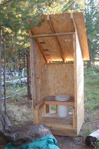

Elpaso- You must have tools. Period. If you in fact know nothing about construction, then build a simple structure. A privy would be good, and would probably be put to use soon after driving the last nail...... and you'd probably discover if wood butchering gets your blood going, or you'd find that doing something else would be your time better spent, along with little monetary outlay. A leanto design is simplest.

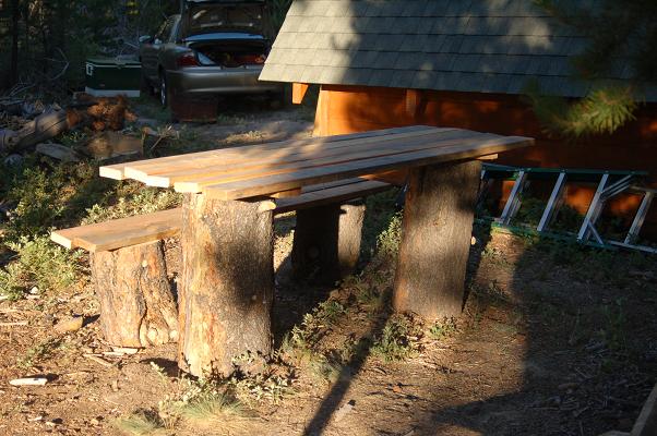

Another item is a picnic table. The one shown is from the warped boards left over from building the cabin, but you'd probably want one more conventional.

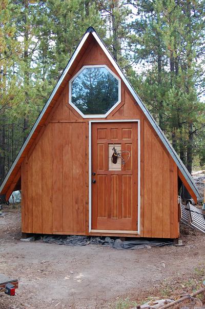

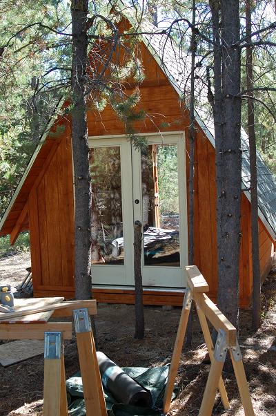

Check out the pix and let me know if you wish to read more. I've got a ton of info and philosophy, and (if you rally want a chuckle) check out our video on youtube. Just type in Gary and Denises Cabin.
I'd love to read about your progress, my fellow GenXer.
Happy Trails
Gary O' privy
| cabin front
| cabin back
