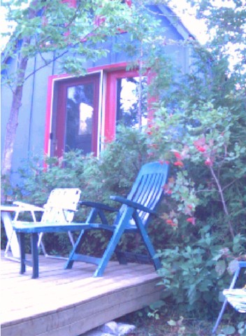

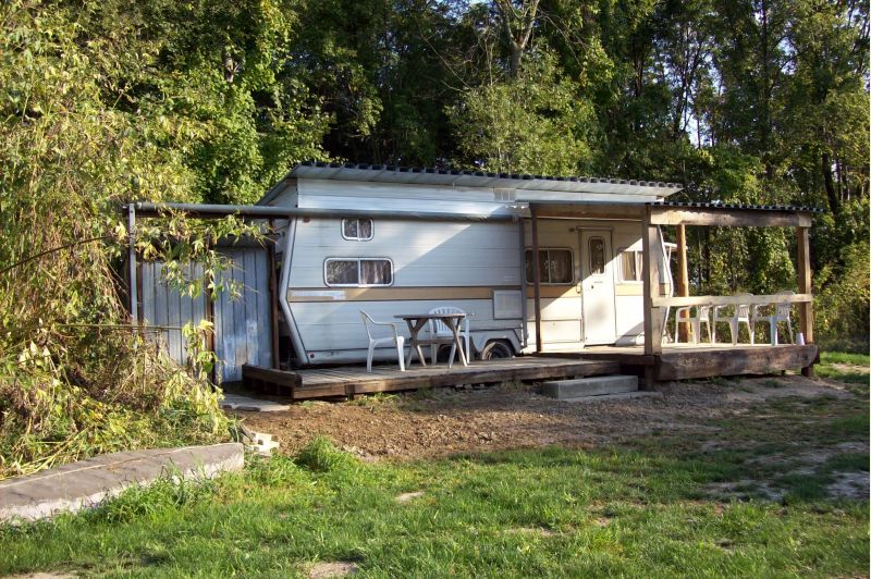

WE too have had both, except we did it the other way 2000-2007 had a cabin 8 x 12 with loft , 2008 till now we 've had a trailer
as DON says the cabin is a much more substantial building . being warmer in winter and cooler in summer . we have added a snow roof to our trailer and a wood stove .total cost for the cabin about 5000 . for the trailer about 2000$ rain water and solar power for both .
i guess it all comes down to your pride and your pocketbook ...
