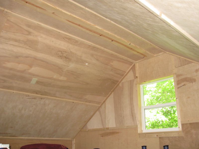

I finally got over to the shack, remembered to take a picture of the ceiling, AND remembered to post it. I talked about this someplace else ... unlike everybody else's cabin, ours isn't perfectly square, plumb, or anything else. I weighed the option of trimming each sheet to fall over the rafters, etc, etc, etc, and decided that if the stuff was only 5 mm thick I should just be able to overlap the sheets. Unless you're in the loft staring right at it, you'd never notice that I've taken this major shortcut. I'm happy with the result and would do it again. FYI, rafters are 2x6 with the standard insulation for 2x4 construction. Some of this has been stapled, some is just friction fit in place, and some is held by the thin plywood. There may be some minor bulging here and there but for a cabin/shack it works just fine. Before somebody points it out, I guess it's not up to code since it doesn't have the drywall as a fire barrier.

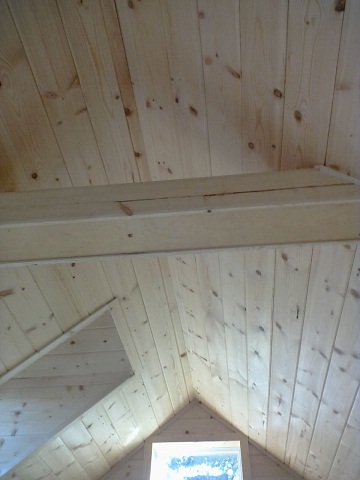

Actually knotty pine's not that much more.
Owen
pine cieling
pine cieling
Rifraf
# Posted: 12 Jun 2012 08:48pm
thanks for the pics, ive already used knotty pine car siding on my lower ceiling, I really like how that turned out .
The t1-11 you put up looks nice

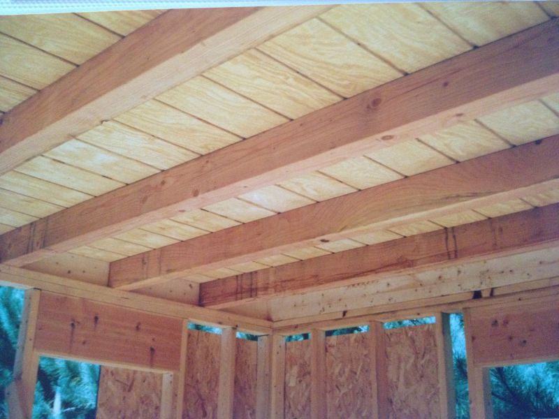

I used it on my ceiling too! I do remember using a stiff bristle broom to brush it off first before I put it up because it had alot of rough particles stuck to it. Sorry...I will get a pic this weekend and post next week...it has been up for 15 yrs now and has aged just like pine to a gloden color...I did not use any stain or clear coat at all.

# Posted: 13 Jun 2012 08:34pm
I found a picture of the upstairs subfloor that I have exposed on the first floor...

Sustainusfarm, the sub-floor of T-1-11 left exposed as ceiling looks great, better than plain plywood! Will you be staining or painting it? I hope that you don't cover it.

adakseabee, this is an old picture of when we started our build...i wanted to leave it natural so no paint or stain...it has aged just like knotty pine and now has a nice orangey glow to it as do the beams. you can see more on my thread "central wisconsin cabin build".

I see you didnt use the 92 5/8" studs on the wall, but the full 96".
As for the ceiling, it looks good, almost dont want to cover it up with insulation.
Anonymous
# Posted: 20 Jun 2012 09:54am
TMT, Not sure what you mean about the studs I used?? the ceiling is not going to be isulated either...
