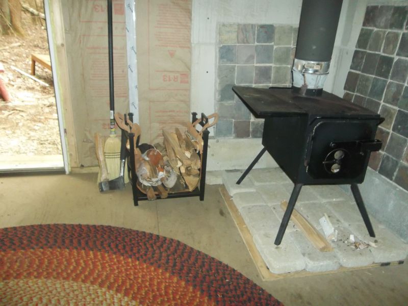

I was in the market for a wood stove for my 8x18 cabin and looked for a long time for a reasonably priced tiny stove to fit my space. I looked at the navigator line and was shocked at the price for there stove. They make some very nice boat stoves over on the other side of the pond for canal boats.
Here is a few. http://www.fluesystems.com/shop/Small_Stoves.html
I bought a Hobbit of ebay I did a review here. http://www.small-cabin.com/forum/3_105_4.html

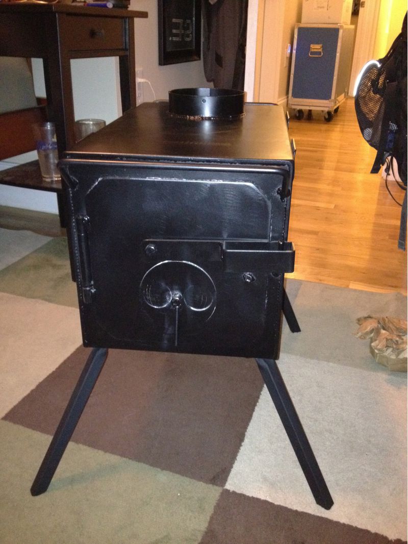

We got the "two dog" stove for our 10x12 cabin. It definitely has no trouble roasting us if we want. Check it out. Reasonably priced and we're very happy so far. I believe it was $235 and measures 11x11x18.
http://fourdog.com/two-dog-stove-dx/
